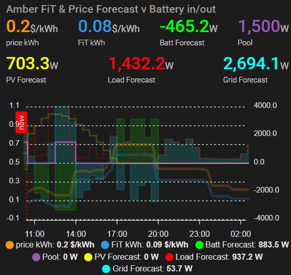

This is how I manage charging and discharging and switching loads on and off. I’m using the EMHASS add-on. This takes a feed of electricity price and FiT forecast (if you have these forecasts available), solar forecast from the likes of solcast.com and some historical data like last X days of power consumption and it produces a plan for the next 24 hours.
I then use the sensors returned by EMHASS to manage the battery and any loads in the house I want the system to manage (car charging, pool pump, hot waster etc.).
Example of a 24hr plan:
This plan has the schedue for charging and discharging the battery and at what wattage. The green below the line is a forecast sensor with charge schedule and wattage and above the line is discharge time and wattage:
You can see this charge and discharge lines up with a forecast of Feed-in Tariff and price from my electricity company (which happens to be a variable wholesale FiT and price). Its instructing the battery to charge in the morning between about 10:30 and 14:00 when the price is low and the sun is shining. Discharge is after 16:00 when the FiT is high.
FiT:
Pirce (which is of cause higher than the FiT):
This plan changes constantly (I run the calcualtion every minute) so the graph has change below. This is the solar forecast from solcast. Which also influences the charge/discharge and load schedules:
Pool pump load (deferrable load that is contoled by EMHASS):
House load. What the system forecasts we will use in the house over the next 24hrs.

I have an EV which also sucks up the juice. I was planning to include it as a deferrable load in EMHASS but so far I’ve left it out of its control. I just pick the best window to charge.
With amber electric (my electricity supplier) I get a forecast of price and FiT so I try to pick the best period to charge.
FiT can fluctuate from -10c to like $17. But I usually get a curve like this:
You can see a spike of $6/kWh yesterday and you want the system to be discharging at that point but to charge an EV I just set it to charge when the price is very low like 13c/kWh in the middle of the day or at 3am.

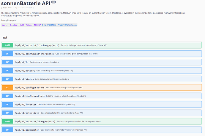

ok I don’t know about the sonnen 8.1 (mine is an eco 9.43) but if its the same then you can control it via REST API.
If your battery is like mine you sould be able to log into it and and select software-integration from the menu. There you will be able to set the API token and all the REST API calls available.
Then you can set up node-red to make these calls when you want.
