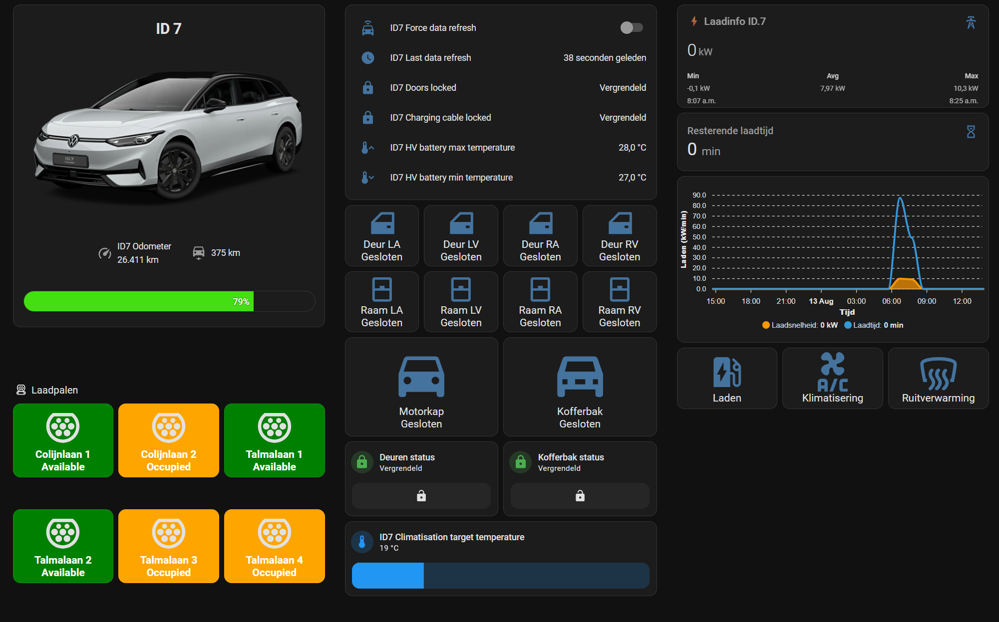

I’ve been busy with my dashboard for my id7.
  • When it’s charging, the image will change to a id7 that’s actually charging and the battery bar also will be animating.
  • I also added a few charging points that I often make use of.
  • When a door, window, trunk or frunk is open, the icon color will be shown red (and obviously the status of the entity will be changed).
What I want to do next is change the image, when a door/window/trunk is open, to the corresponding image just like in the VW app.
Then I can remove the separate icons.
