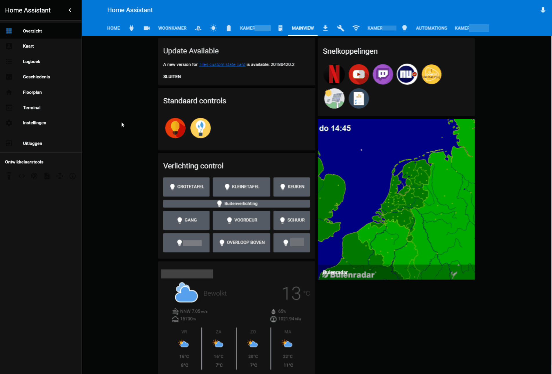

HI, as a side topic on your example, how do you get the Buienradar screen to show up and be dynamic?
Ok nice to know im not the only one. I will keep an eye on the github thanks!
As for the buienrader screen i added a camera with these settings:
platform: generic
still_image_url: http://api.buienradar.nl/image/1.0/RadarMapNL?w=500&h=512
