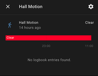

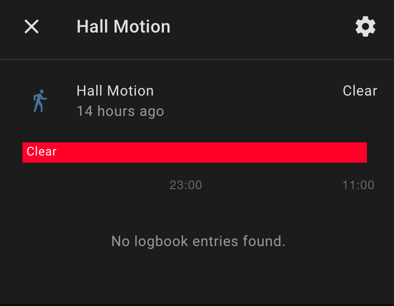

Thanks. The automation worked for a few days but now it seems something has gone wrong with the integration. As best I remember, the device used to show on/off state but now it just shows ‘clear’.
The IP address hasn’t changed and the sensor still seems to be working, judging by the LED light. Any ideas?
You need to check the logs for additional pointers.
