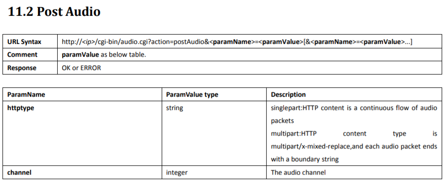

As far as sending sound files back, I don’t think the integration has anything for it (but would have to check to be sure). If you look up the docs for it though, you might be able to find a URL to post to that could do it.
Quick google uncovered this:
Post #3 has a link to Dahua HTTP API.
Reading down through it I found this on page 94:
So it appears if you post to that address you might be able to play audio… but just a guess… never tried it :slight_smile:.
Good Luck!

Now as far as playing audio via Amcrest component or any camera via HA streaming, that is not supported by the stream component, as verified in this post.
At the bottom of this post there was a nicely detailed solution using the ffmpeg_noise binary sensor platform.
