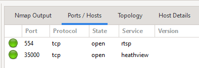

Can you do a portscan to see what’s open?
Never done this before so hopefully I did it right, this is what I got:
Going to dm you if you don’t mind with some things to try out - hopefully we can figure this out.

I was able to get the error codes to change slightly (didn’t document it at all) Specifically where it references port 5000 (line 356). I tried changing this to 35000, 3777 and i believe 37777 (I found some references to these somewhere online). I did try to get nmap working, but first time using it, and was taking forever (i think i was scanning all ports without ping?) not sure.
