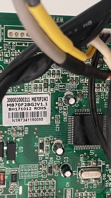

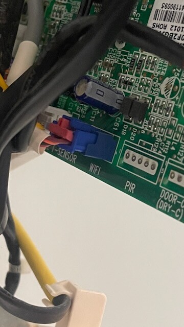

I have 6 Daikine Mini Splits.
But none of them is S21.
They all have a 4 pin blue connected as WIFI port.
I opened one unit, and to my surprise, it looks like Daikine, for some reason - probably $$ - uses Gree control boards.
No S21 for me. In any of the - sold as high level, branded Daikine - units.
See pictures.
