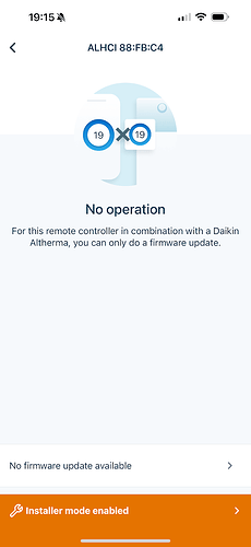

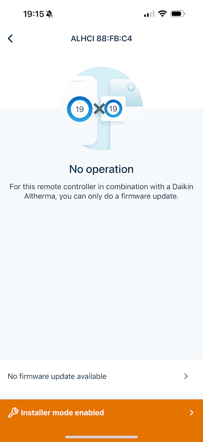

I have a Altherma 3M 8kw with Madoka BRC1H HDAW. I tied the app before setting up Home Assistant but it shows very limited information. Have anyone seen this before? Any solutions for enabling more information. Google gives no hits on the error.
How would you connect another Madoka controller to this configuration?

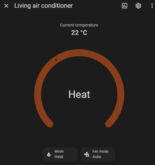

My issues is most of the time, my control is in a weird state where it looks like it’s connected but it’s actually isn’t.
This is how it looks:
and this is the log that get to this state:

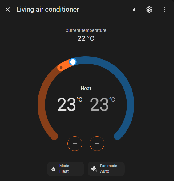

When it is really connected, this is how it looks:

In the first snippet you posted, I see just the pairing process going on. Once it succeeds, it should always automatically connect to the esp. In more than three years of usage, this never happened to me.
Could you share your configuration? Maybe you got issues on that side.

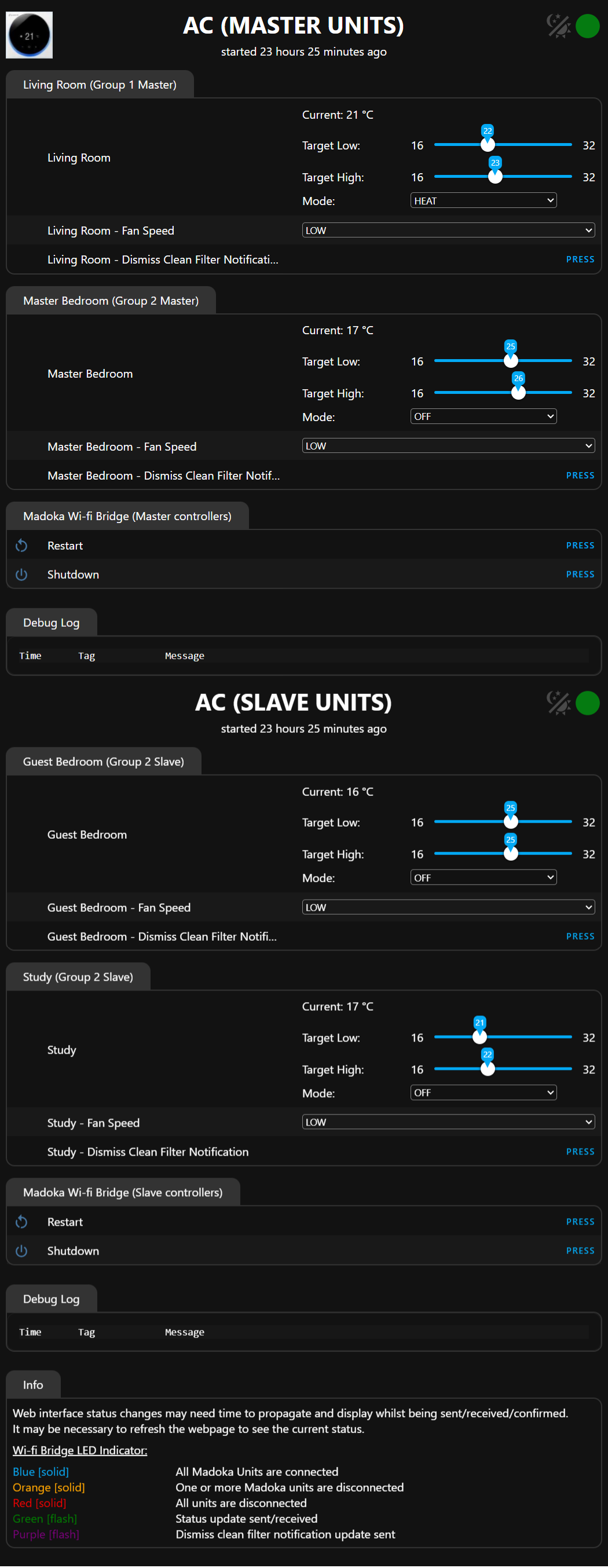

I changed my Madoka unit to operate with dual setpoint as in theory this offers better control.

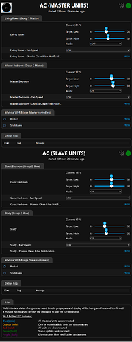

To get what I wanted (HA independent control), I have edited/forked code, added yaml control, and customised esphome>web_sever_.js so that:
  1. Heat and cool fan speeds now separately update and changeable in all modes including Auto mode directly (also with HA, which before was not so for auto mode). Commented out all but high and low fan mode as that’s all my setup support, but you can remove the comments to bring them back).
  2. Added clear filter notification option so that it can be cleared without the app.
  3. Added Madoka graphic, multi-device (due to esphom ble 3 connection limit) via single web page with linked theme adjustment and default to full width (double clicking device name tabs reveals logs). You can use yaml and js as a template to add more devices/pages, and change iframe ip addresses to mdns but its not android supported. Maybe someone could add mdns fallback code)
  4. Added esp32 led status indicator and similar to error logs.
esphome/esphome/components/madoka at madoka Ā· rawframe/esphome Ā· GitHub (The yaml and js files are added to the fork)
Here is a screenshot of the webpage:

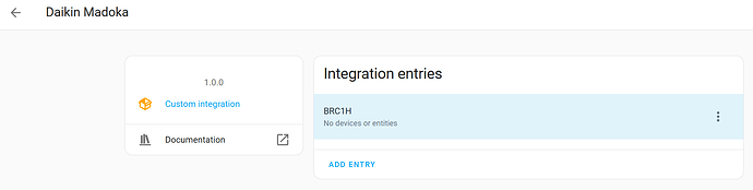

Hi community,
I would really appreciate your support as summer is coming and it will be unbearable in my apartment without remote A/C control…
So, I was a happy user of this custom integration, running on rPi 4 with ASUS BT dongle (yes I know it is not reliable but in my case it was working quite fine).
Then, few months ago something happened and after one of the HA updates I was not able to regain control of my two MADOKA devices.
I though few reboots will help but no avail.
Yesterday I decided to redo complete installation, delete pairing and custom integration. Now I have them parired and integration is loaded but no devices/entities are detected, see below picture:
I can see some errors in the log related to MADOKA but I do not know if they are fatal or what…
Debug log can be found here (I’ve opened issue on the git as well but it seems relatively quiet there):
ā€œhttps://github.com/user-attachments/files/19438148/home-assistant_daikin_madoka_2025-03-24T21-02-47.931Z.logā€
Is anyone here running this integration sucesfully with HA 2025.3.4?
Any suggestions where should I look?
Thanks!

Here is what I did:
  1. delete MADOKA custom integration using the web interface
  2. login to your HA
  3. cd /homeassistant/custom_components/daikin_madoka/
  4. if you want you can backup content of that folder: ā€œtar tzf madoka_old.tar.gzā€ then ā€œmv madoka_old.tar.gz /rootā€
  5. erase the content of that folder: ā€œrm -rf *ā€
  6. wget https://github.com/amnsharif/daikin_madoka/archive/refs/heads/patch-1.zip
  7. unzip patch-1.zip
  8. restart HA and add MADOKA custom integration
and it should detect already attached MADOKA controllers…
