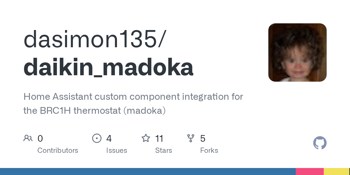

For anyone interested, I’ve switched to this:
It is more current and has more deployment options.
