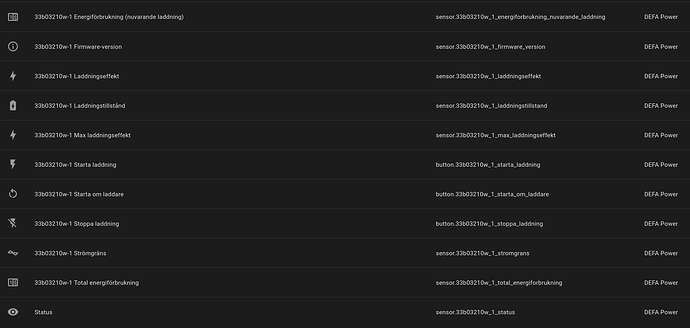

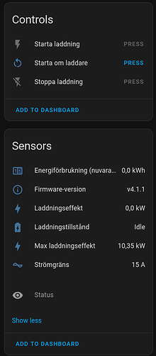

In your screenshot there is a meter value that seems to show total consumed energy. When I added this I am missing that, could that be due to my firmware version?
Edit: It showed up now after a while on the device, seems it can take a while to populate the list of entities?
I can see it under all entities but not under the charger for some reason
