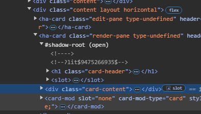

it’s these 2
# ha-card-border-width: 0
# ha-card-border-radius: 0
commenting both of them returns the scrollbars
You got it!!!
Reproduced.
Will think how to fix.
@Mariusthvdb
Seems that values without uom (here - “px”) causing an error in “calc()” function.
