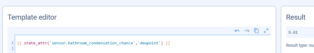

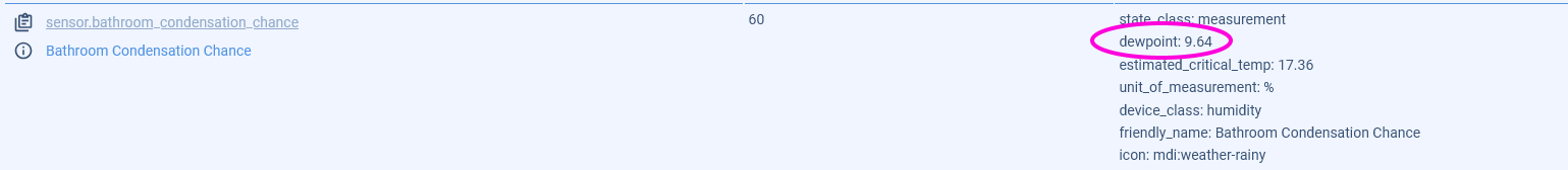

I don’t see any dew point attribute in the Mo(u)ld Indicator.
It is definitely there.
sensor:
  - platform: mold_indicator
    name: Bathroom Condensation Chance
    indoor_temp_sensor: sensor.bathroom_temperature
    indoor_humidity_sensor: sensor.bathroom_humidity
    outdoor_temp_sensor: sensor.outside_temperature
    calibration_factor: 2

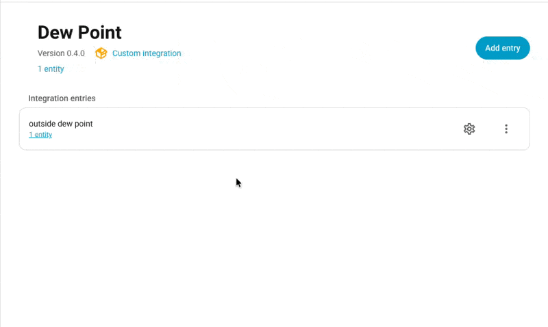

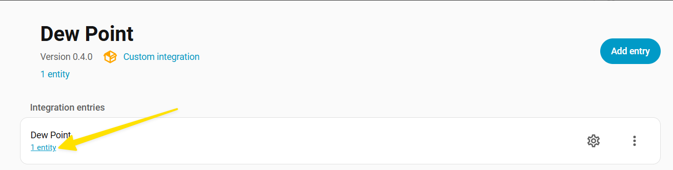

I was able to install your dew point sensor and added my thermometer’s temperature and humidity sensor information, but then what? I can see the integration, but I don’t see an option to see the value or add it to my dashboard.
There is one sensor created as far as I can see on the picture
Yes, I only created one sensor, but I’m not sure what to do with it. How do I get it to display the dew point? Thanks!
It creates a sensor, that sensor shows the dew point.

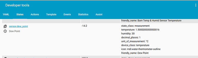

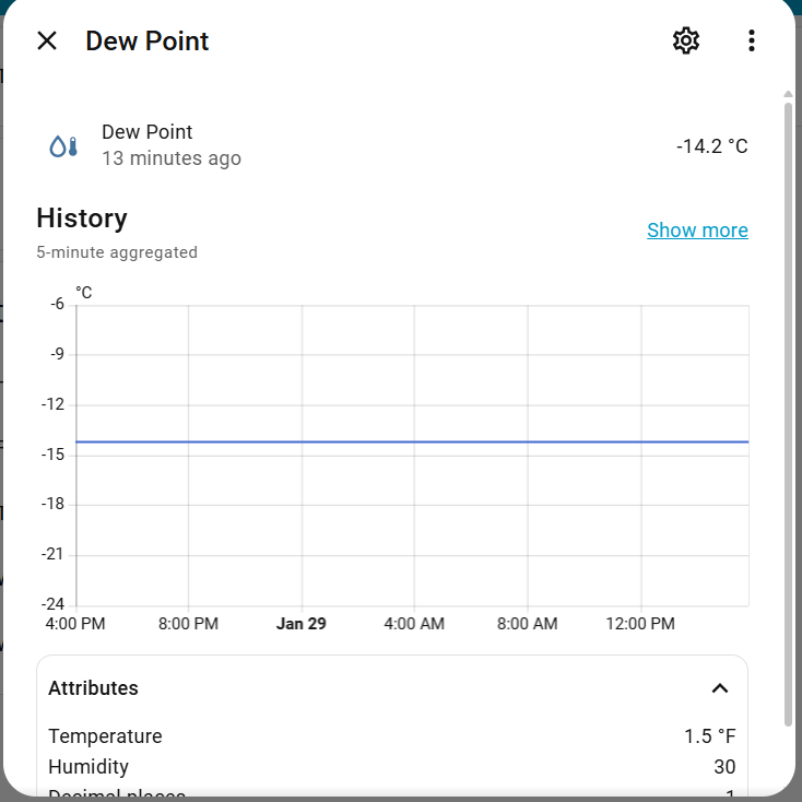

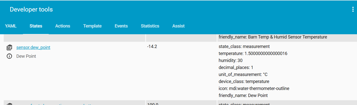

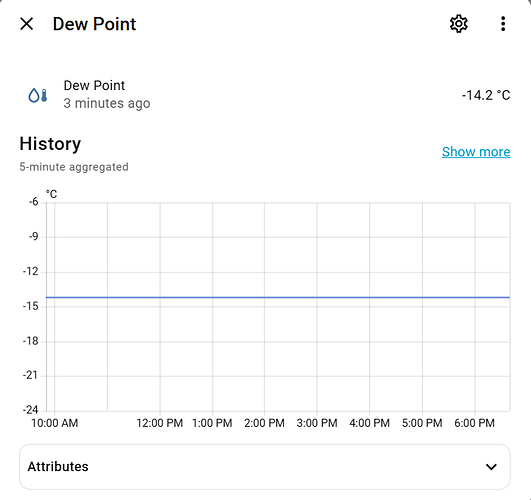

I think my issue is cause number 1, and possibly something else. My thermometer reports in C. But still not sure why (see the first screen shot), the attribute for temp is 1.5F, while it should be around 53 with an input of 12C.
Is there a way to get around the problem of a thermometer reporting in C? If not, do you know of any fairly accurate, bur reasonably priced thermometers that report in F?
You’re reading it correctly.
Your Dew Point sensor is actually calculating correctly based on its inputs. With Temperature ≈ 1.5 and RH 30%, the dew point ends up around −14.2 °C, which matches your screenshot. So the formula is fine, the issue is that the temperature entity used as input is wrong (value and/or unit metadata).

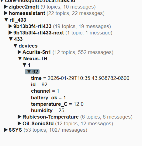

From your rtl_433 MQTT payload we can see the raw value is correct:
temperature_C = 12.0
Best way around this is to bypass the auto discovered temperature entity and create your own MQTT sensor that reads temperature_C directly and labels it as °C, then use that “fixed” sensor as the temperature source for the dew point sensor.

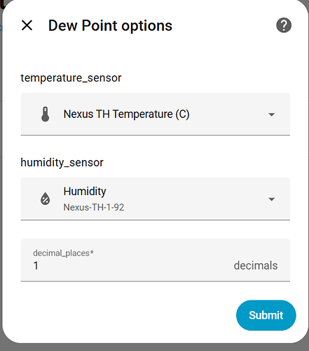

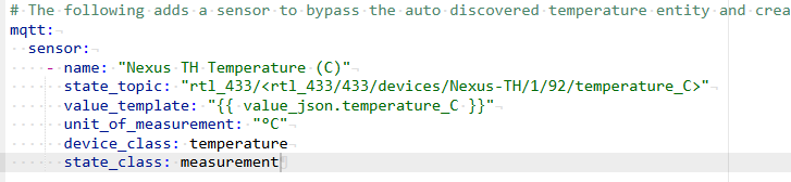

I placed the code you provided into /homeassistant/configuration.yaml.
Then added the new sensor to dew point
But for some reason, the attributes under the dew point sensor haven’t changed, even after a restart. However, the data is being updated correctly in MQTT Explorer.

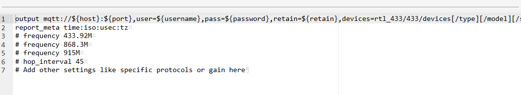

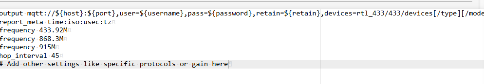

I think I have something wrong with my rtl_433 code. I’ll do some googling to see what might be wrong.
Anyway, here is the full rtl_433 topic
rtl_433/433/devices/Nexus-TH/1/92/temperature_C
and here is the sensor mqtt info (debug) for the sensor

I commented out a few of the lines I thought might be causing the error because of noobie formatting errors, but now the attriburte in dew sensor is unknown. Will do some more troubleshooting/googling.
Thanks, this is very helpful. I think the main issue is the MQTT template sensor.
You are subscribing to a “field topic”:
rtl_433/433/devices/Nexus-TH-1/92/temperature_C
That topic typically publishes a raw payload like “12.0”, not a JSON object. If the payload is just a number, then this template will never work:
{{ value_json.temperature_C }}
Result: your new temperature sensor stays unknown, and Dew Point keeps showing the last valid attributes (still 1.5°F, 30%) even after changing options.

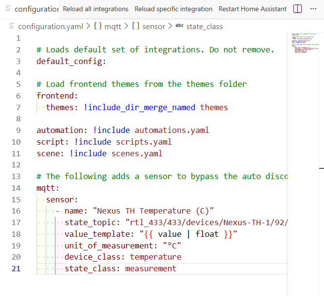

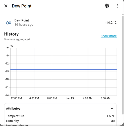

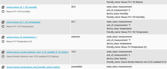

Although still not working, there was one change. It is not showing unknown anymore. But it is still reading 1.5F.
I pasted the new code into configuration.yaml

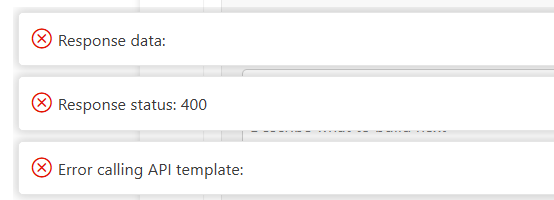

Almost as soon as I did (I was using Studio Code Server), the following popped up:

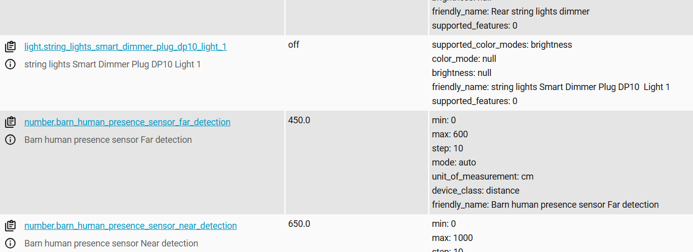

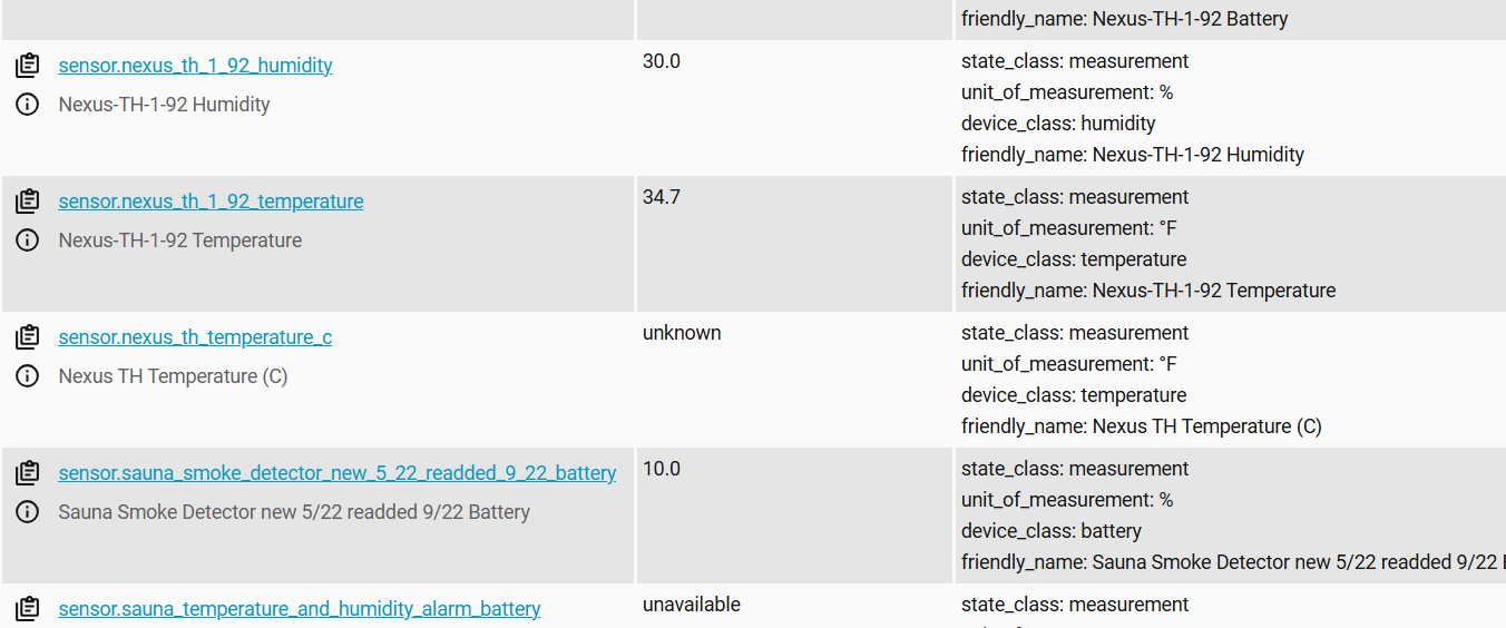

Another data point - when checking Developer Tools - States, Nexus TH Termperature(C) does not appear.
However, the Dew Point Sensor does:
I checked MQTT Explorer and the sensor is still there, current temp is 11.5C.
I did reload the Dew Point integration and also restarted HA.
I’m sorry this is taking so long. I want to contribute, but I can’t seem to find your link. Can you send it to me? Thanks!

Two separate things are happening here:
  1. The “Response status: 400 / Error calling API template” is very likely from Studio Code Server trying to render the template via HA’s Template API. In that context the variable value does not exist, it only exists inside the MQTT sensor template context. So that warning is annoying, but not the root cause.
  2. The real issue is that your new MQTT sensor is not being created. If “Nexus TH Temperature (C)” does not show up in Developer Tools → States (or in Settings → Devices & Services → Entities), then Home Assistant did not load that YAML sensor. In that case the Dew Point integration will keep using the previous temperature entity, which is why you still see 1.5°F.

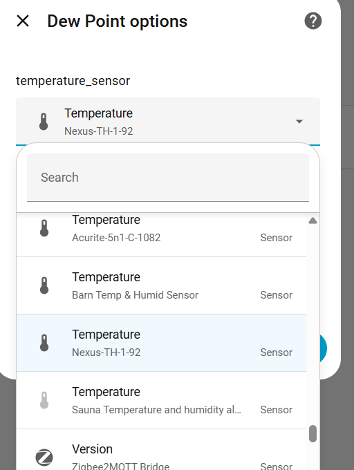

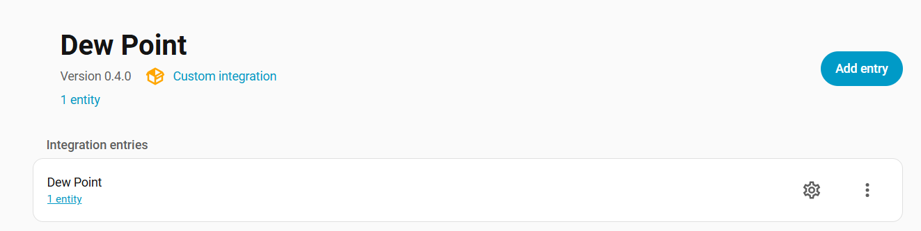

There were no errors or duplicate mqtt: engries, but we are making progress:-). Now I can see the sensor we added under Developer Tools - States:
Unfortuantely, it is not listed as an available sensor in Dew Point integration:
The new sensor doesn’t appear in MQTT Explorer either, but my guess is that it shouldn’t because we created a virtual sensor from the actual sensor data.

Perfect, we’re close. Right now the “fixed” sensor is still unknown, and that’s why it won’t show up in the Dew Point dropdown.
We need to confirm ONE thing: what is the actual MQTT payload on the temperature topic.
Do this:
