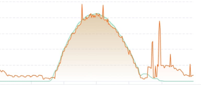

I’m using the [dazboj]'s Tesla-Smart-Charging blueprint, wich is working flawlessly. As you can see, it manages to harvest almost every watt from solar production to charge Tesla:
Even when there are clouds I have a nice tracking of the power curve:
