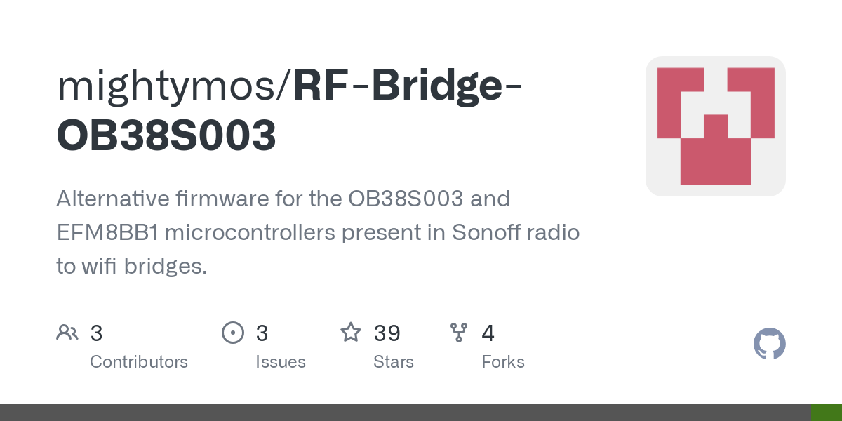

This might be a good solution for Sonoff R2 v2.2 hardware, i.e., the white box:
Full disclosure I am the project author.
This is quite interesting. I don’t have this hardware yet, but interesting in buying it for a particular couple of use cases. The GitHub repo says WIP but you are saying it’s working well enough to recommend it? I’m pretty handy with flashing custom stuff onto electronics if the instructions are clear, so that isn’t an issue. One example use case is looking to use my flipper zero to get the signal from my doorbell and have home assistant be able to be aware of it through the Sonoff RF Bridge which I would buy for this.
