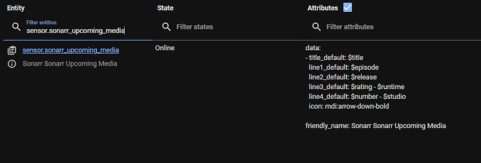

Hey guys, my sonarr upcoming media stopped displaying
 upcoming media lol
It says its online, but nothing is showing up?
Any ideas?
I tried removing and readding, radarr is working fine.
The only thing is there is nothing coming up for some 11 days?
Thanks

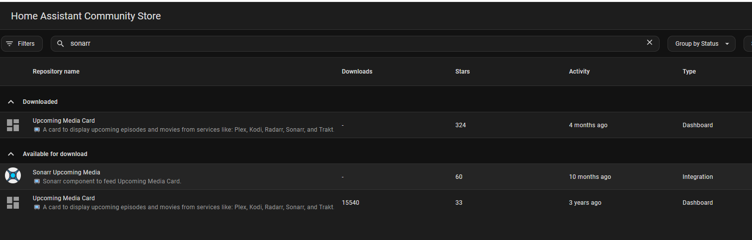

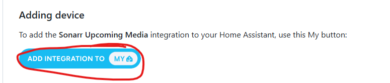

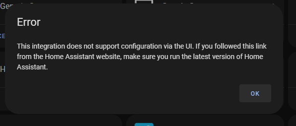

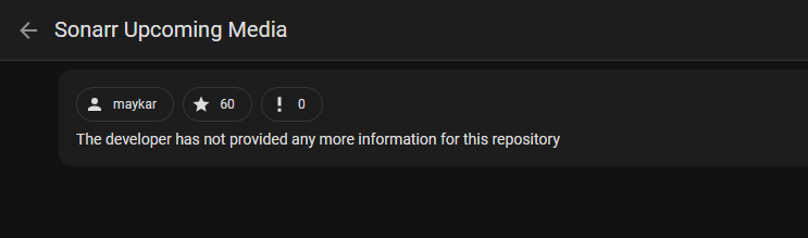

Just an FYI, Im getting;
When trying to add the sonarr upcoming media card from the;
Also, I cant see your one I think when looking though HACS
IS that the old one right?
Hi @liminal it looks like you tried to install the wrong/much older repo on HACS. You have to be careful not to install older/outdated forks of the original/official repos that don’t support installing via UI.
The older/incorrect forked repo was last updated over 3 years ago. You want to install the one that was last updated 4 months ago. You need to select the top item in your screenshot.below by maykar (original developer of the official repo).
NOTE: You need to remove/uninstall any versions of Upcoming Media Card, Radarr, Sonarr, etc
 you currently have downloaded/installed, reboot, then install the more recent versions (like the top item in your screenshot below)
Yeah that must have been it, it was only showing the older one. Rebooted and I could get the new one installed.
