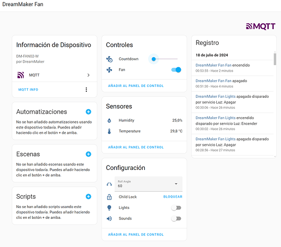

I had problems with my Dream Maker fan a few days ago because it was unable to connect to the DM servers.

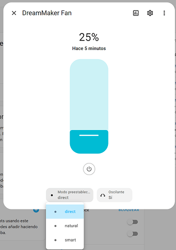

This has made me take up again the project that “direx” mentioned called dmio2mqtt (abandoned since almost 3 years ago), I have updated it to adapt it to docker, to use a device id instead of the IP in the mqtt topics and what I consider the most comfortable of all, I have added compatibility with the MQTT Discovery of Home Assistant.
I leave here the link in case anyone is interested:
Greetings
