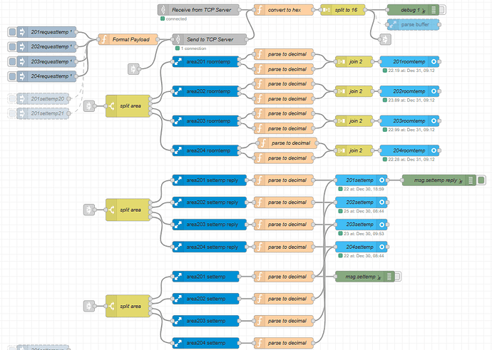

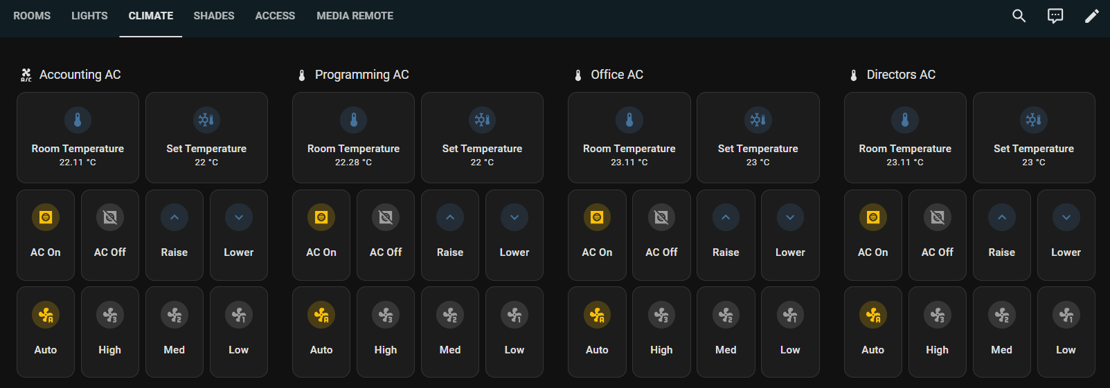

Ok i got mine working on node-red. i am now able to get the room temp, set temp, raise and lower from dynalite AC controller (DDFCU) and antumbra then exposing that entity to HA. it is bi-directional and interactive sync with antumbra display and HA UI changes.
