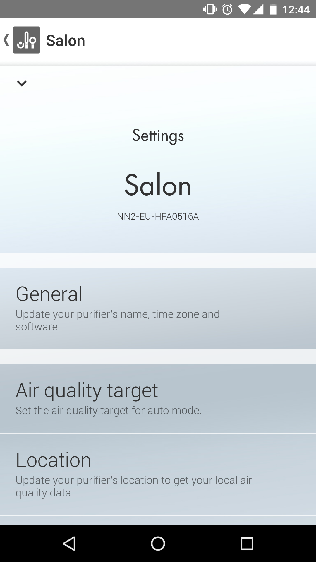

As you can see, I need the devices ID too. I can be able to use the device name (Pürity and Cooley in your feedback) but I think device ID will be more reliable. The question is: How to find device_id ? In fact you already had your devices ID in the debug logs you provided (PE8-UK-HHA0158A for example) but you can also use the Dyson link mobile application to get the device ID (on the device page, click on Settings)
NN2-EU-HFA0516A in my example.
