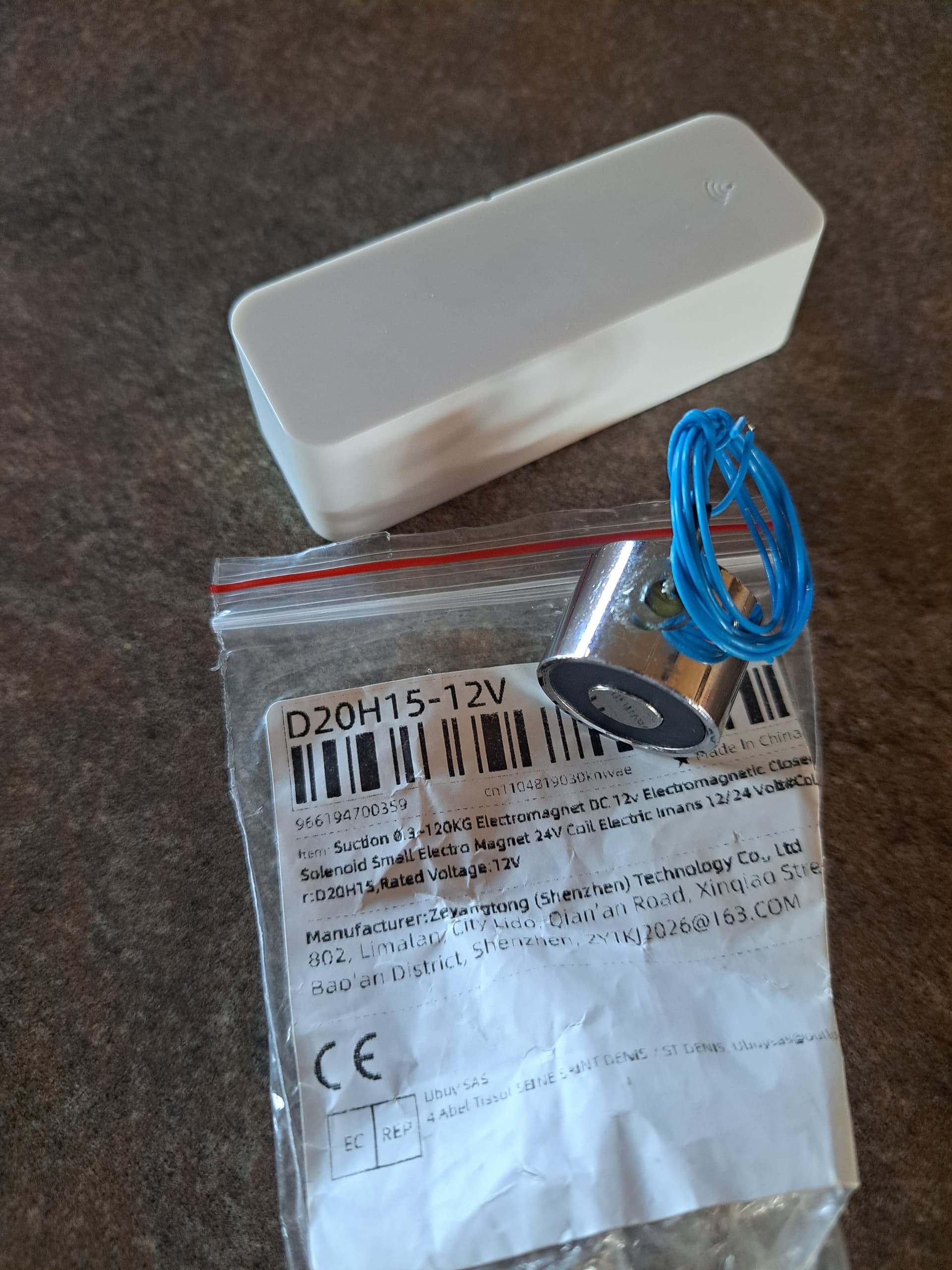

Here is my solution to enable a “dumb” solenoid doorbell to work with automation.
I’m using a cheap generic Tuya zigbee door sensor (no need to use the included magnet). Just couple that door sensor with a micro electromagnet. The electromagnet is hot-glued to the door sensor and then wired in parallel to the door solenoid using the screw terminals. Current draw on the electro-magnet is about 300ma, so very low.
The whole thing fits inside the doorbell housing easily with a piece of Velcro. It’s a clean solution and doesn’t require soldering. Simple install.

Here are these micro electro-magnets on AliExpress.com. They have many versions, all slightly different. They were rated 12/24v. D20H15-12V is the one I picked.
Suction 0.3~120KG Electromagnet DC 12v Electromagnetic Closed Solenoid Small Electro Magnet 24V Coil Electric Imans 12/24 Volt
