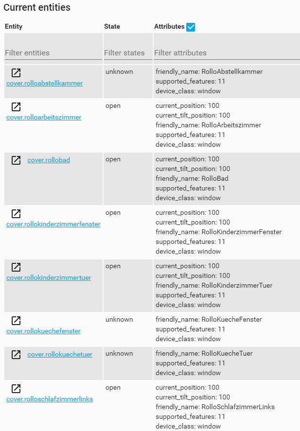

I do have another problem, since one of my (10) shutters shows as unknown state in HA.
It does work when I click up/down/stop it’s just the state that is not recognized for some reason.
Anyone has same issue? Is the communication problem between stick and shutter, or stick and HA?
I have the same issue that some of the shutters show “unknown” state in HA. :frowning:
And I’ve no idea about the reason or how to investigate the reason, as I am not really familar with HA.
To be more precise: We have 13 Elero shutters and 5 of them have permanently ‘unknown’ state, but all of the 13 shutters are of the same model / type / …

Yeah same here. All shutters / motors same model, but just one shows “unknown”.
