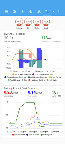

I’m really happy with this plan today from EMHASS.
Unusually today I have very little variation between maximum and minimum prices during the day, so EMHASS isn’t trying to madly charge my battery to 100% and a nice balance of charging my EV (green) and running my air-conditioning (red).
