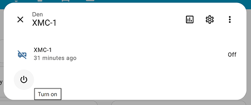

The problem remained the same as in the previous version. All volume management commands such as volume +, volume -, mute work perfectly. Also on/off works. All the other commands (source as HDMI1, or info, stereo etc. etc. instead of being executed, open the processor status window, this one that I show in the image below:

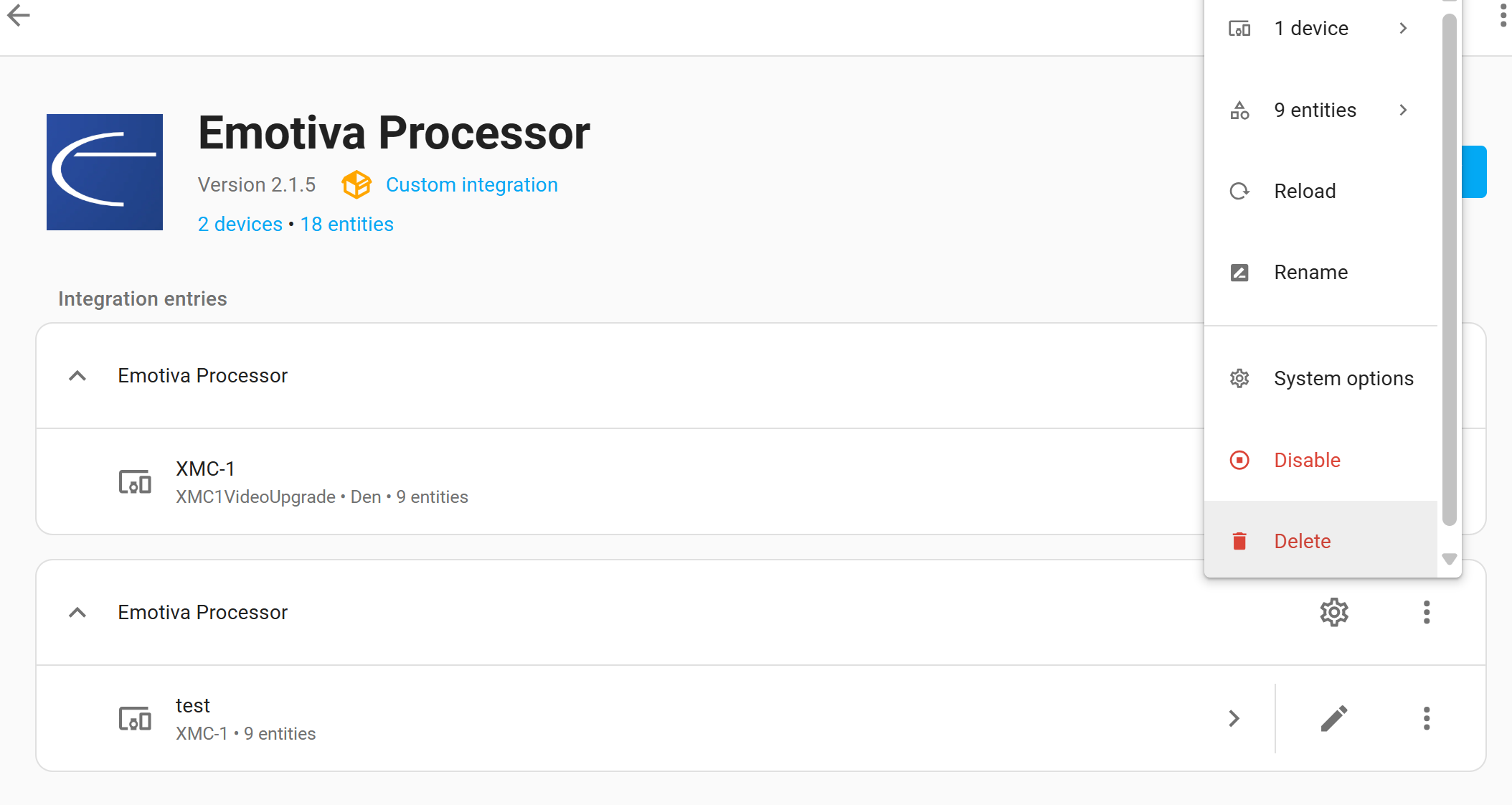

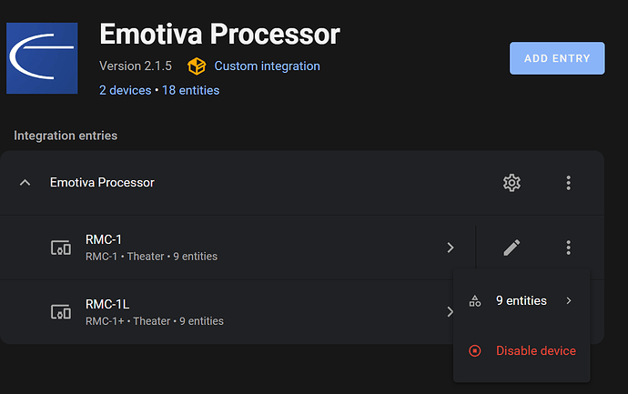

I recently upgraded my RMC-1L to an RMC-1L+. Now I see both processors in the integration. I’d like to delete the old one (and ideally rename all the entities on the new one to what they were with the old one), but I don’t see any way to delete just the processor. It looks like I can only delete the entire integration. Am I missing something?
Maybe deleting and reinstalling the integration would actually get the entities named correctly again?
I’m not sure why you can’t delete - under the 3 dots next to the integration. This is what I see if I add a dummy second processor.
Interesting. All I see is the disable option:
I restarted Home Assistant just in case, but that didn’t make any difference.
Ah - that makes sense. It’s auto discovered the devices so they’re showing up under the same configuration entry - the entry basically says to discover all the devices it can and add them. You’re not really deleting the integration by hitting delete next to Emotiva Processor, but you’re deleting the config entry which says “discover”. So, to get rid of the existing devices, you’ll have to delete the config entry I’m afraid. I should probably move the discovery to the config flow, and then it would create separate config entries, but it’s not been a problem before
No problem - this is really an edge case. I’ll delete it here in a bit and see how it goes. Thanks for the reply!

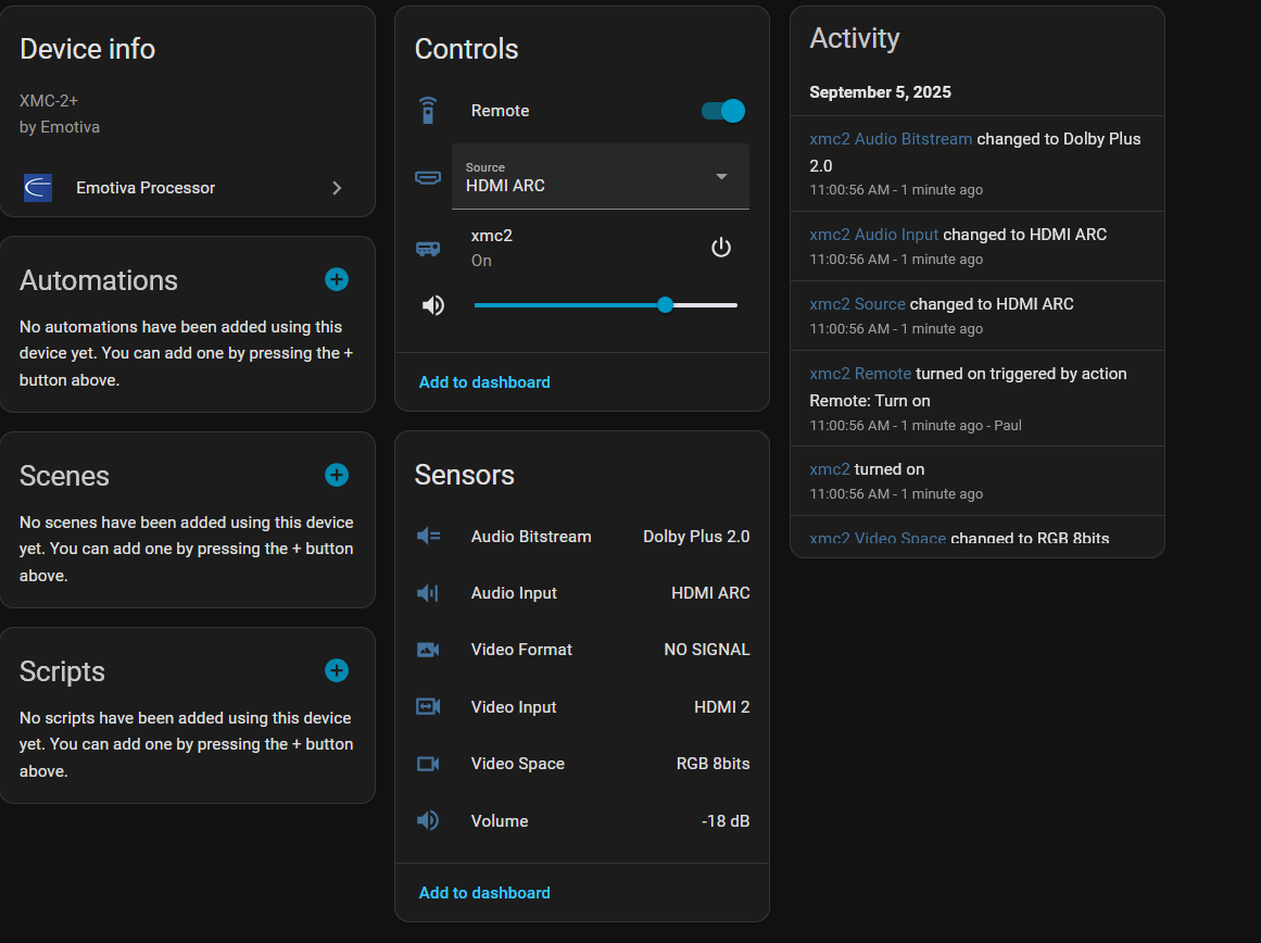

Anyone have issues with the new + processors not showing on in HA? Prior to doing the CR8 upgrade it used to work with no issues. Now when my XMC2+ is on HA isn’t reflecting the current state. Once I flip the remote on under control then it actually shows the current state of my XMC2+.
I can’t test things with CR8 (or any of the new gen) I’m afraid, as I don’t have one so it’ll take a bit of digging. First question - could you be a bit more specific on the behaviour. After you’ve turned the XMC on with the remote, does the power state then work (i.e. turning on and off) or if you turn it off again does it stop working until you use the remote again? I wonder if there’s a network standby mode that needs to be enabled perhaps? Can you ping the XMC before you turn it on with the remote? If you’d like to turn on debug on the integration and attach some logs, I’ll take a look.
When I turn on my XMC-2+ using the physical remote in Home Assistant (HA), the power state accurately reflects the current status, i.e., it shows as “on” in HA. I am also using a Sony OLED XR-77A80J TV with CEC control to turn my XMC-2+ on and off. This might be the issue, as HA does not seem to detect or capture the state change when I turn the TV on or off. The state in HA remains unchanged.
Additionally, in HA, I can turn on the XMC-2+ using the remote slider button or the power button. When the unit is off (in standby mode with the orange light), I can ping it successfully with no packet loss.
