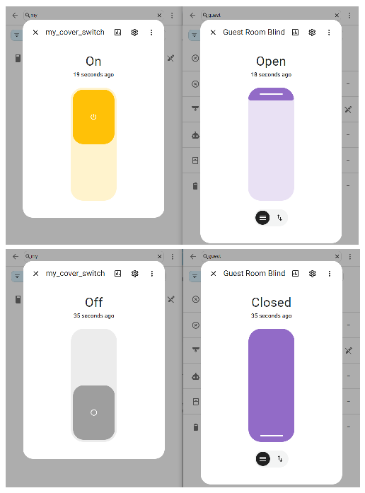

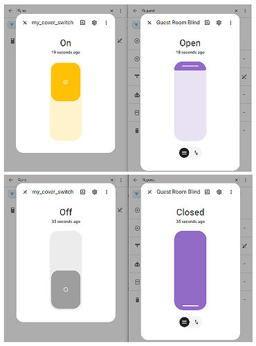

@sender @Asafalfs You can expose a cover as a switch by using a template. This is defined in your configuration.yaml file. The documentation for a switch template is here.
I created one to test this on my system. This cover points to one of my roller shades. When the switch is turned on, my roller shade goes up, when the switch is turned off, my roller shade goes down. Just expose this switch in your emulated hue configuration and reference it from Alexa.
Here is the yaml.
switch:
  - platform: template
    switches:
      my_cover_switch:
        value_template: "{{is_state('cover.guest_room_blind', 'open') }}"
        turn_on:
          action: cover.open_cover
            entity_id: cover.guest_room_blind
        turn_off:
          action: cover.close_cover
