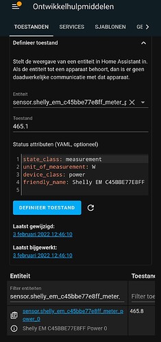

What is going on with the state of sensor.shelly_em_c45bbe77e8ff_meter_power_0 ?
Just updating as normally
Was it just a one off error on start or are you seeing lots?

Yeah I can reproduce this. Something has changed with the min function and it is no longer happy that it has a list to iterate over. I am not sure that I have a solution immediately to hand. Someone who is better at templating than I might have a solution but I will keep googling for a result…
Ahh sh*t, there goes my energy dashboard, haha.
Try this:
{{ [states.sensor.shelly_em_c45bbe77e8ff_meter_power_0.state | float(0) | multiply(-1), 0] | min }}
