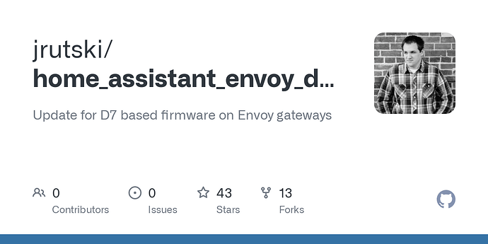

I am currently using the briancmpbll fork of the Envoy integration. I’m having some intermittent problems with HA sometimes no longer getting the data from my IQ Envoy (combiner 4). The symptom is this :
"Retrying setup : Error communicating with API: Request URL is missing an http:// or https:// protocol.
Sometimes, HA will recover and reconnect to the IQ Envoy on its own. Other times, not. I tried setting an automation that reloads the Envoy integration hourly, but it made things worse, so I stopped doing that. A “quick reload” of HA does not fix things. A full “restart server” does fix it.
I have seen it happen randomly in the middle of the day to overnight all night.
Just to be clear, my IQ Envoy of course has a static IP DHCP address reservation in my router, and I pointed HA to this static IP address . I run smokeping from a Pi and know that the IQ Envoy is available on the network when those issues in HA occur.
Any help about this would be appreciated.
It doesn’t look like @gtdiehl has done anything for over a year.
I have an existing system running firmware D5.0.62 (5e57a9) but our new system (expansion) today came with D7.3.120 (ac5b3c) so I’m in a pickle on what to do. @HA_n00b did you end up installing something via HACS?
