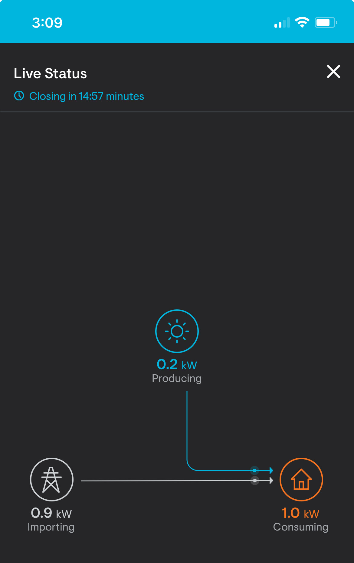

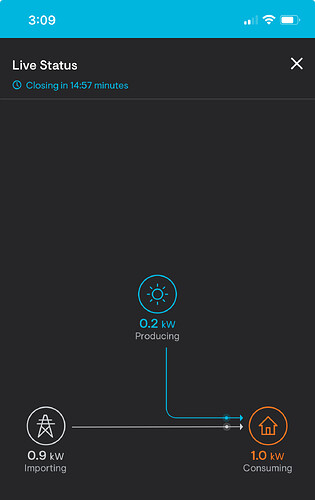

Is this streaming end point always active, and this just listens to it? Or does it need to be “activated”? I’d really like to figure out how to confirm it isn’t taxing the envoy CPU.

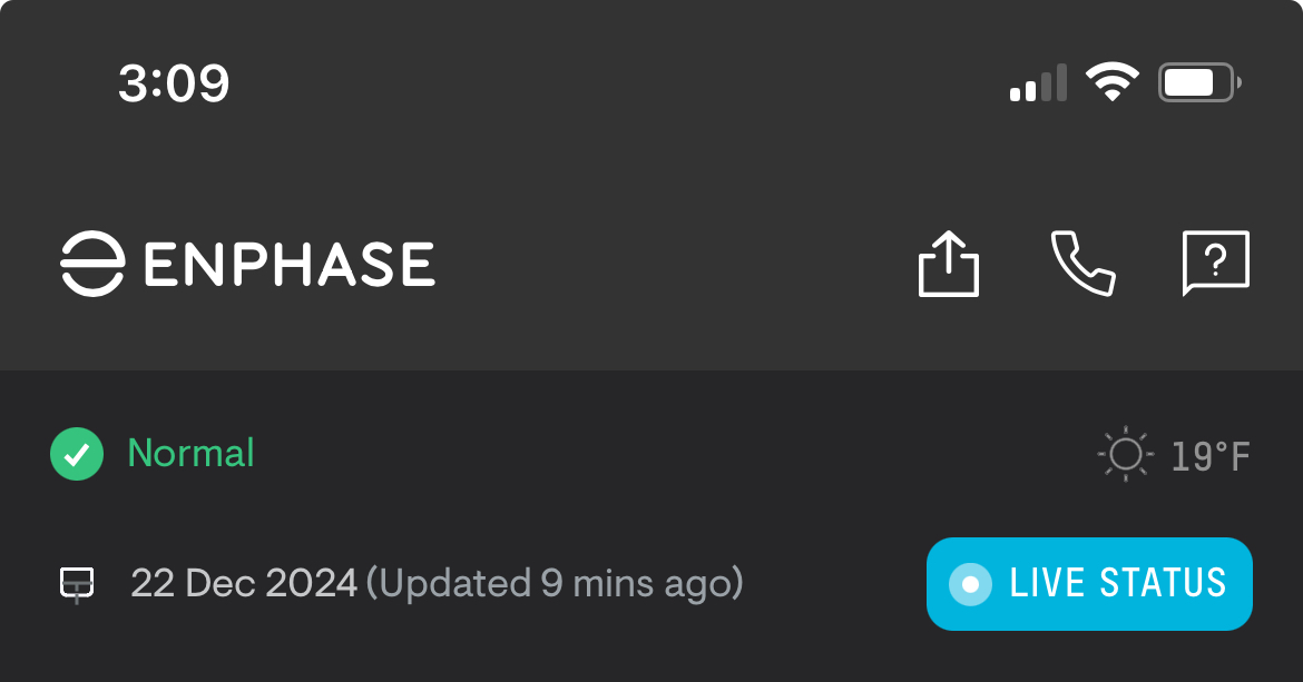

My enlighten app has a “live status” button that seems to capture the same streaming output (it’s definitely updating real time). It also only works when I’m locally connected and doesn’t work if I’m away from home. Is it this button in the app that essentially activates the same streaming output? If so, the button only allows streaming output of 15 mins then closes. Might this be protection to avoid over taxing the envoy?
@jwaters23 - I’m not sure how many other ways I can confirm that the streaming output puts negligible load on the Envoy. I’ve been connected to that streaming output for multiple years 24x7 and it has never missed a beat or caused any issues whatsoever. The stream is an output, it’s always there regardless of if you connect to it or not., and the Envoy doesn’t even know you’re connected so there’s no need to worry.

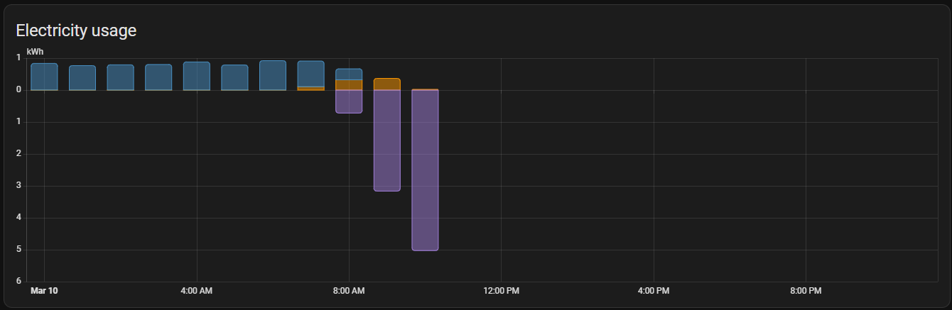

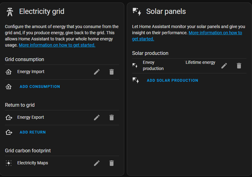

I’ve tried a few different things now trying to get the Energy Dashboard to display my consumption correctly.
Default suggestions from the integration:
  • For Grid consumption, use the Envoy SN Lifetime net energy consumption entity.
  • For Return to grid, use the Envoy SN Lifetime net energy production entity.
Entities suggested in this thread:
Energy Import/Export
Power Import/Export
I am currently using the Energy Import/Export, yet when the graph is generated, it shows me consuming no power when solar is being generated.
Any help to point me in the right direction would be appreciated.

It might have to do with how your CT clamps are installed in relation to your interconnect. On my system, Envoy reports production correctly but mistakenly reports Grid Consumption as a combination of what my actual consumption is PLUS my solar production. I ended up getting an Emporia Vue 3 and track my consumption that way. Then I created two sensors, Emporia less Solar = Grid Consumption, and Solar less Emporia = Return to Grid. This still gave me all kinds of wacky numbers in the Energy dashboard, so I made a custom dashboard and use Energy flow card plus. Now everything matches my electric bill perfectly.
