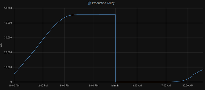

Here is the graph showing a reset to 0 at midnight every day
On this page New sensor state class: total_increasing | Home Assistant Developer Docs
I found this statement that explains why last_reset is not needed for this sensor
For sensors with state_class STATE_CLASS_TOTAL_INCREASING, a decreasing value is interpreted as the start of a new meter cycle or the replacement of the meter. It is important that the integration ensures that the value cannot erroneously decrease in the case of calculating a value from a sensor with measurement noise present. This state class is useful for gas meters, electricity meters, water meters etc.
