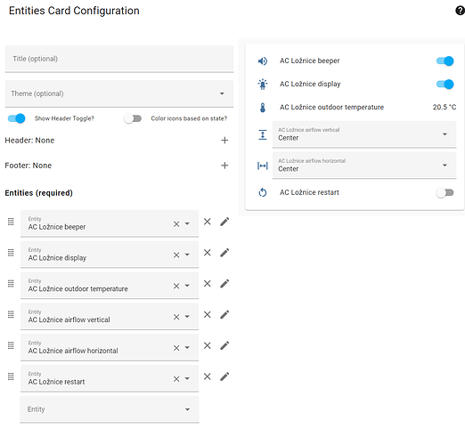

There i could turn off the screen and the beep. I don’t see any possibilities now is they right?
if you switch to the dev branch https://github.com/paveldn/ESP32-S0WD-Haier/blob/2370ee2ed611f016d5c671d04a2d6bc373e7b8f3/haier.yaml
there is beeper option for commands sent from HA
beeper: true
also I think there is now option to disable beeps even from remote.
IIRC beeper: false in config also disables display, but i’m not really sure if it was on hOn or some of my own smartAir2 experments :slight_smile:
@Knol010 Also I think that maybe it can be confusing that beeper, display etc. are separate settings from climate so you need to add more entities
