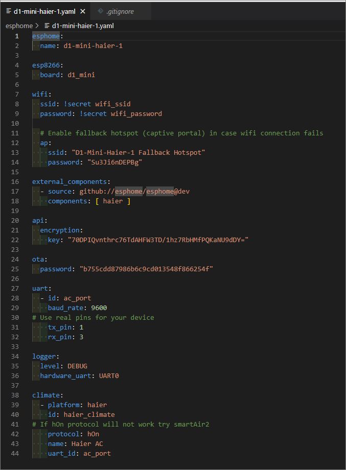

I installed the ESPHome add-on in Home Assistant and added the new device (Wemo D1 mini) using a USB cable. After this I soldered a cut USB cable to the Wemo and plugged it into my Haier. The Wemo shows up as “online” in the ESPHome Dashboard. So far so good.
But how do I now add the Haier functionality to the Wemo? What is the next step?

So I assume you have secrets entered for your device (because you see it online). So please edit the config for your device and use this basic configuration:
esphome:
esp8266:
  board: d1_mini
wifi:
  ssid: !secret wifi_ssid
external_components:
  - source: github://esphome/esphome@dev
    components: [ haier ]
api:
ota:
uart:
  - id: ac_port
    baud_rate: 9600
# Use real pins for your device
    tx_pin: 1
    rx_pin: 3
logger:
  level: DEBUG
  hardware_uart: UART1
web_server:
climate:
  - platform: haier
# If hOn protocol will not work try smartAir2
    protocol: hOn
    uart_id: ac_port
It is just the most basic thing. Feel free to change all things you need (like device name or PINS for UART port).
hmm I had already experimented with this but I guess I am missing something. How do I get the Wemo to represent itself as an AC control in Home Assistant? I guess normal behavior would be to add it to the dashboard from configuration but in the screenshot below I only have “firmware” there. Did I miss a step?
