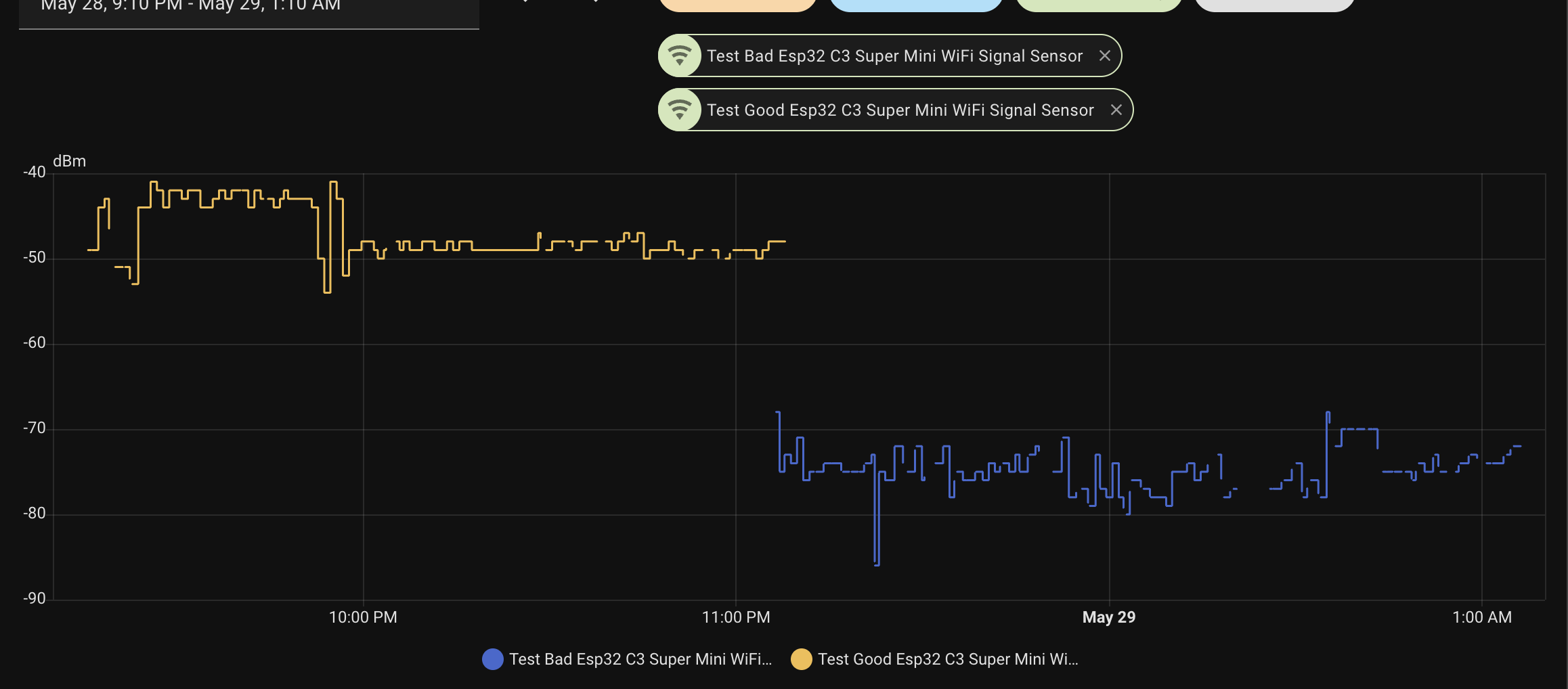

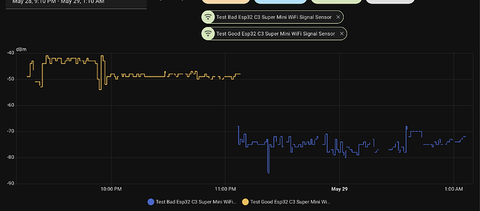

I bought several batches ESP32 C3 Super mini from Aliexpress. Some of them clearly have bad Wifi antenna design. Their Wifi signal strength is significantly worse than the “good” ones, as tested below in a controlled environment.

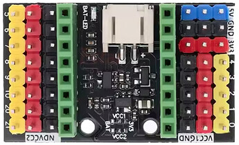

I have a similar C3 super mini board (Tenstar branded) working with sensors connected (a display and an I2C sensor).
  • Same framework as @jonwalton389 noted above.
  • GPIO20 & 21 in use for I2C.
  • GPIO0, 1, 2, 3 8 all in use.
  • Powered via the C3 USB-C connector.
  • Sensors connected via expansion board below (no battery connected).
Very reliable, no boot / wifi issues under this configuration.
I switched from the expansion board to a mini-breadboard and could no longer connect to wifi. Boot was successful every time (my display was working) but wifi would not connect. Swapped back to the expansion board and everything works again.
Perhaps the expansion board is providing better power regulation? Has anyone else experiencing problems tried using an expansion board?
Better power regulation than what? From the other side of the internet i confirm your skepticism about power is plausibly the issue.
So experiment.
  • Run the power from expansion board to said mini board.
  • Find another 5v power supply like from mobile phone and use that for power…
  • Obtain answer to your suspicions…
Potentially better power regulation for the 3.3V supply to sensors via battery management circuitry, but this is a guess. In both my test cases the configuration is powered with a dedicated plugpack via USB-C connector on the C3, the difference is sensors are connected via the expansion board in my working case and directly to the C3 pinouts in the non-working case.
I’ve not yet traced the circuit on expansion board (nor found any doco) for any potential differences in 5V / 3.3V / VCC1 / VCC2 supply pins on the expansion board. Another check will be powering via battery connection on the expansion board, once I get the right connector.

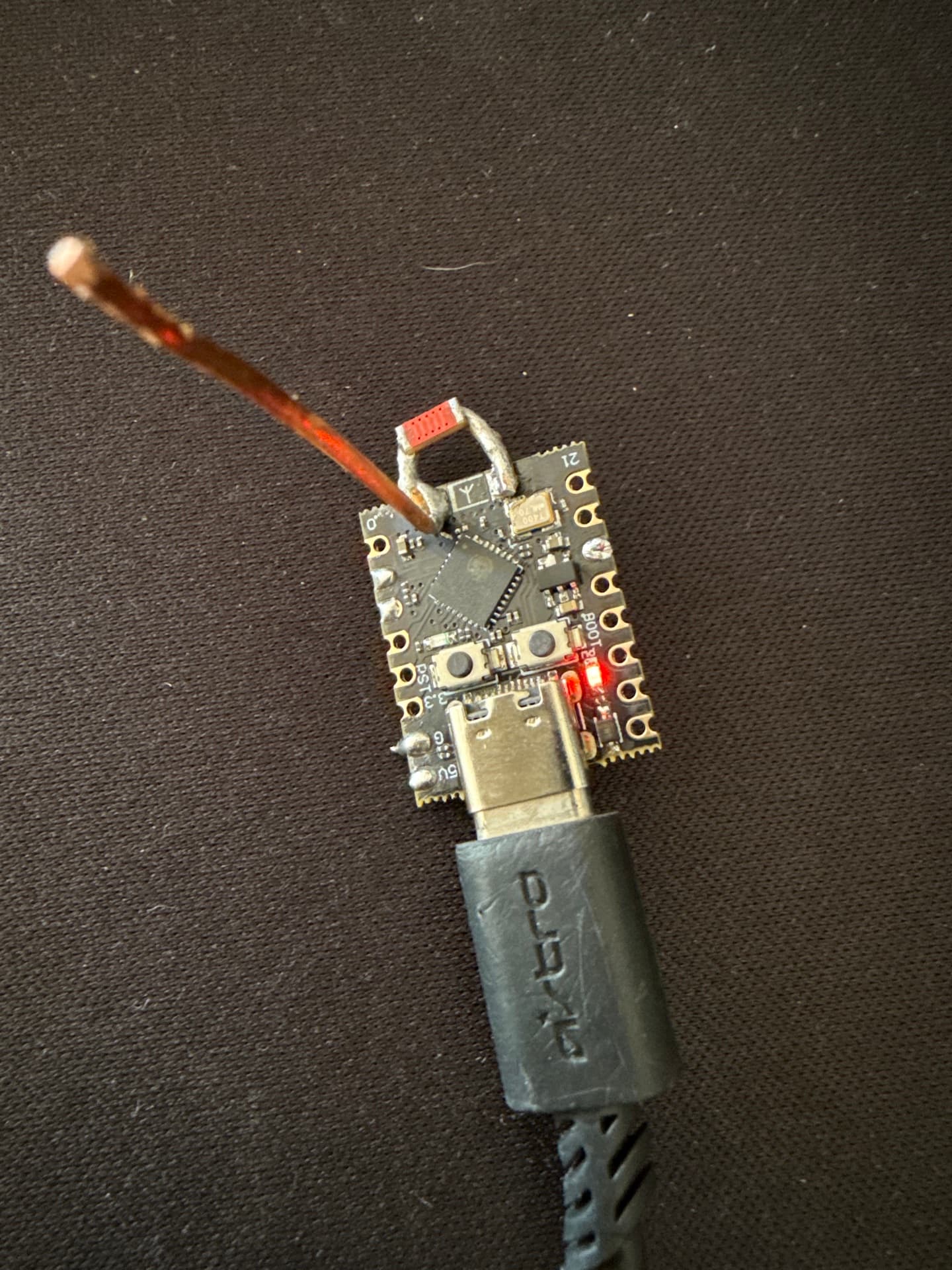

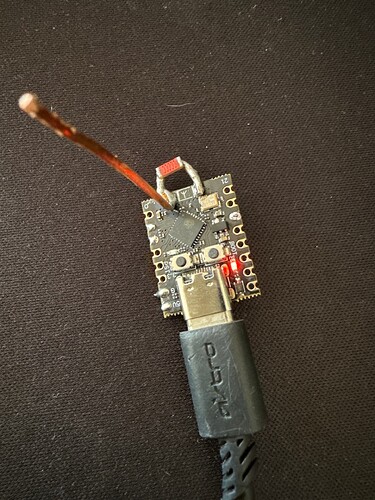

Hi! I had the same issue with the ESP32-C3 Super Mini—Wi-Fi wasn’t working. I think I found a fix. Initially, I tried moving the little crystal slightly, but it didn’t help. Then I created a small external antenna to increase the distance, and now everything seems to be working perfectly.

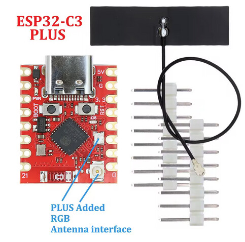

I have tried several ESP32-C3 Super Mini boards and pretty much all had disappointing wifi performance.
I highly recommend the ESP32-C3 Super Mini Plus, which comes with an external antenna.
It gave me around 5 Db signal boost.
