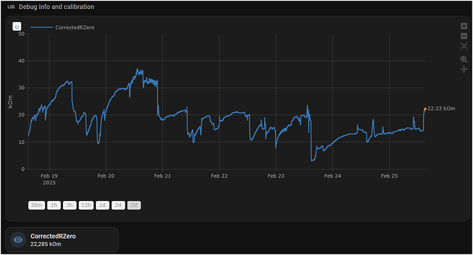

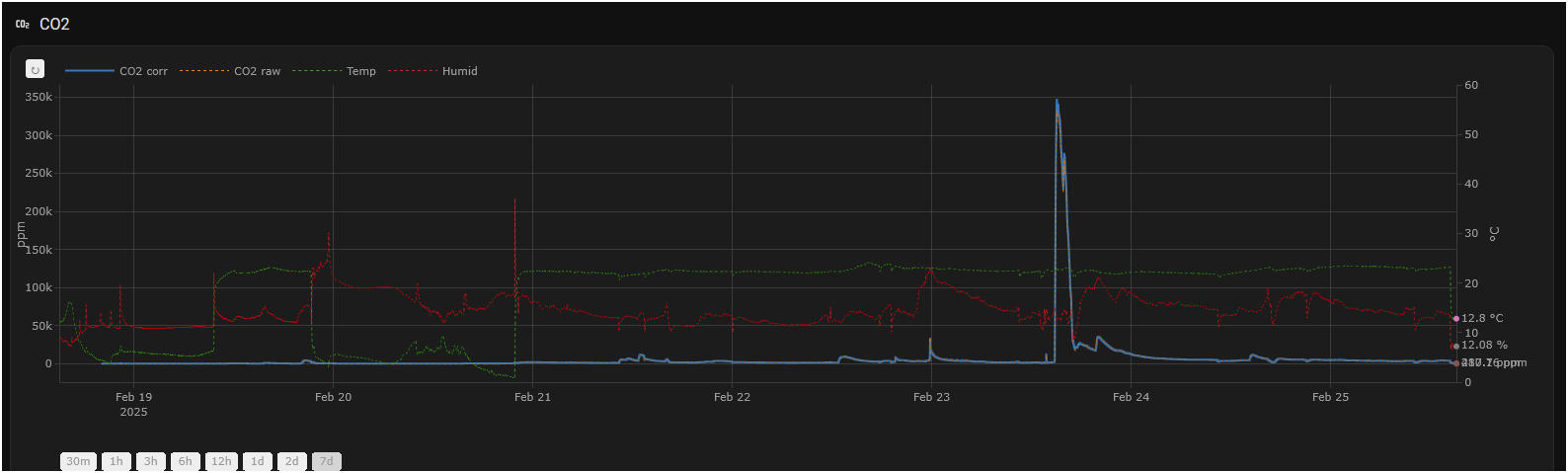

Interestingly, this sensor still drifts strangely:
  • Twenty-four hours at the balcony, and values are continuously drifting upward.
  • A few days at home env, in the bedroom and values are up to tens of thousands!
The PPM:

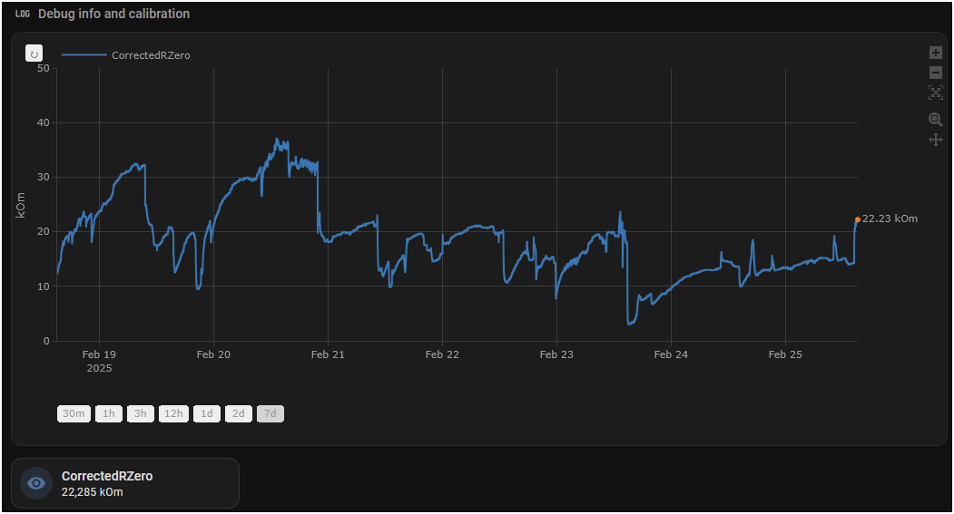

The correction resistance drift graph:
I don’t think this sensor is reliable for CO2 measurement, and it’s instead the air quality at max.

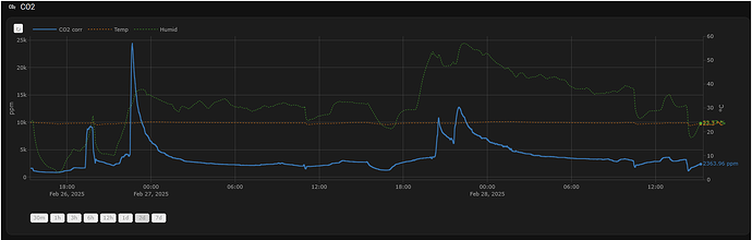

UPD2: The MQ-135 sensor is utterly unreliable. After I’ve fixed all my flaws, it is still pretty inaccurate. This sensor will panic as soon as you start cooking, for example. The CO2 levels will go to the sky level.
Here is the graph for 2 days of CO2 stats in the bedroom:
There is SOME correlation between people sleeping in that room and opened windows, but all peaks are random, the biggest one just cooking in the other room!
