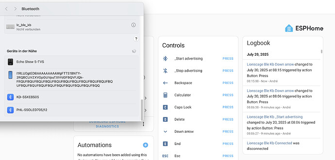

However I am experiencing a different issue. After the ESP restarted, it is not connected anymore. From the looks of this thread no one else experienced that. Is this an isolated issue on my device? Or am I missing some configuration?
For those having trouble with devices (particularly Apple devices) not reconnecting after the ESP32 restarts, I’ve pushed some changes which seems to resolve the issue for me: GitHub - zachdekoning/esphome-blekeyboard: ESPHome BLE Keyboard
From doing some research, it seems that Apple devices don’t like the lack of security in the pairing process. The way around this is to set a proper pairing code, which seems to allow my iPad to properly reconnect when the ESP32 restarts.
You can try out these changes with the following:
