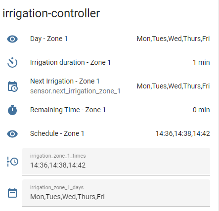

Here is my yaml that works
# 1 Zone Version

Here is the dashboard results of the code that will compile
It looks like your irrigation.h file has a different version of the update_next_runtime() function. My original version assumes watering every day, so that function only needs a list of times passed to it. You need to find a version of that function which accepts a second parameter with a list of days.
Oh!, Very cool. Thank you. Though maybe I can set a “water everyday” button to switch between both functions.
So this is now working correctly. I set it up with substitutions throughout so its relatively easy create new ones rapidly and integrate them into HA based on what they do. These are for single relay esp-01s. Thank you very much everyone.

Problem found!
Unable to find action with the name ‘text_sensor.template.publish’.
platform: homeassistant
  entity_id: input_text.irrigation_zone_1_days
  on_value:
    then:
        Unable to find action with the name 'text_sensor.template.publish'.
        text_sensor.template.publish:
          state: !lambda |-
            return id(ui_zone_1_days).state;
sensor.template: [source /config/esphome/esp-irrigazione.yaml:215]
  platform: template
  name: Day - Zone 1
  on_value:
    then:
          state: !lambda |-
            return update_next_runtime(id(irrigation_zone_1_times).state, id(irrigation_zone_1_days).state);
