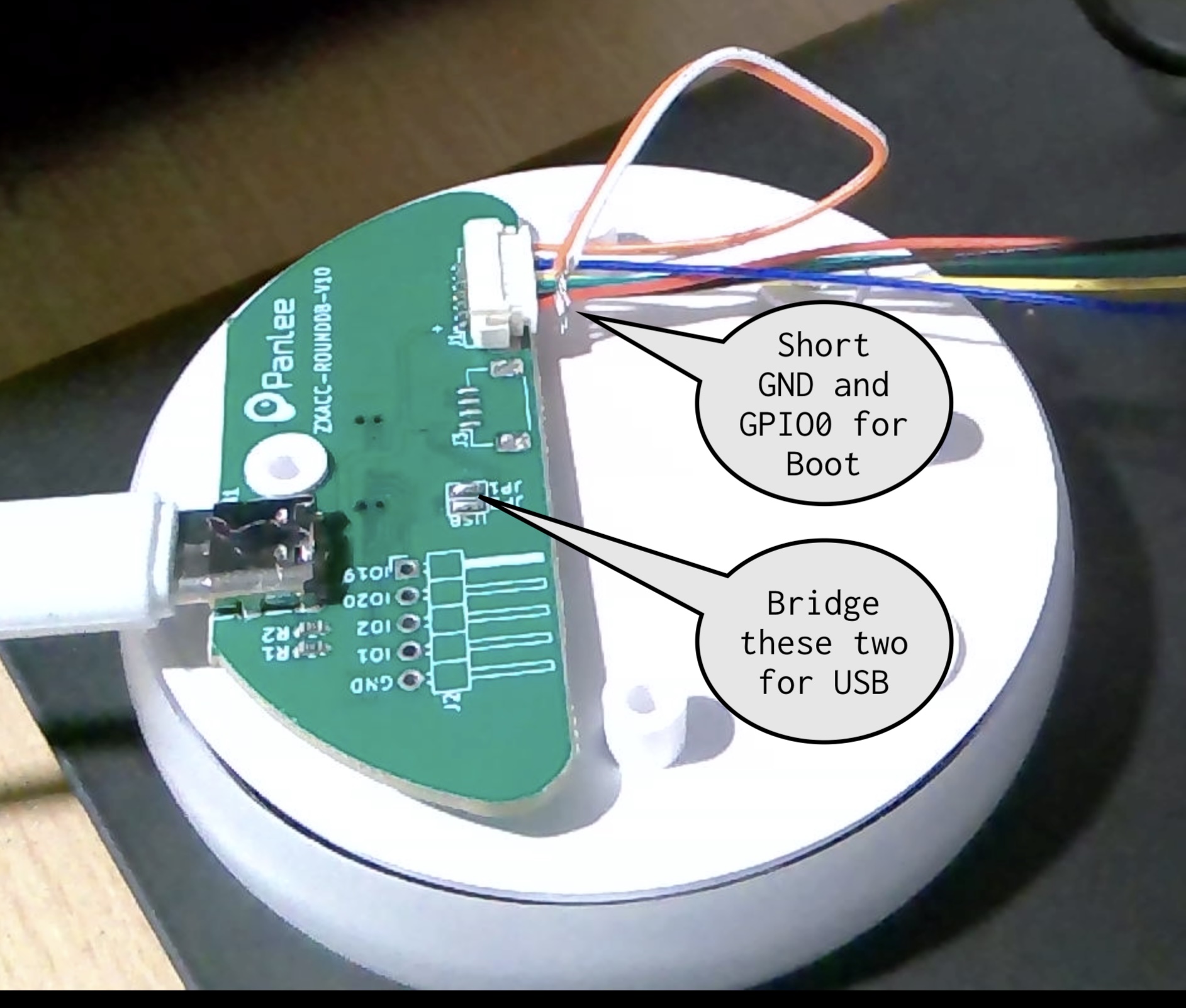

Circling back to this, I’ve added this device (zx2d10ge01r-v4848) to the upcoming mipi_rgb display driver as a pre-defined model, so the required yaml for the display is just as below.
Secondly, you can flash this over USB by bridging the USB pads and shorting GPIO0 to GND for first boot (the stock firmware doesn’t enable the USB-JTAG serial port.)

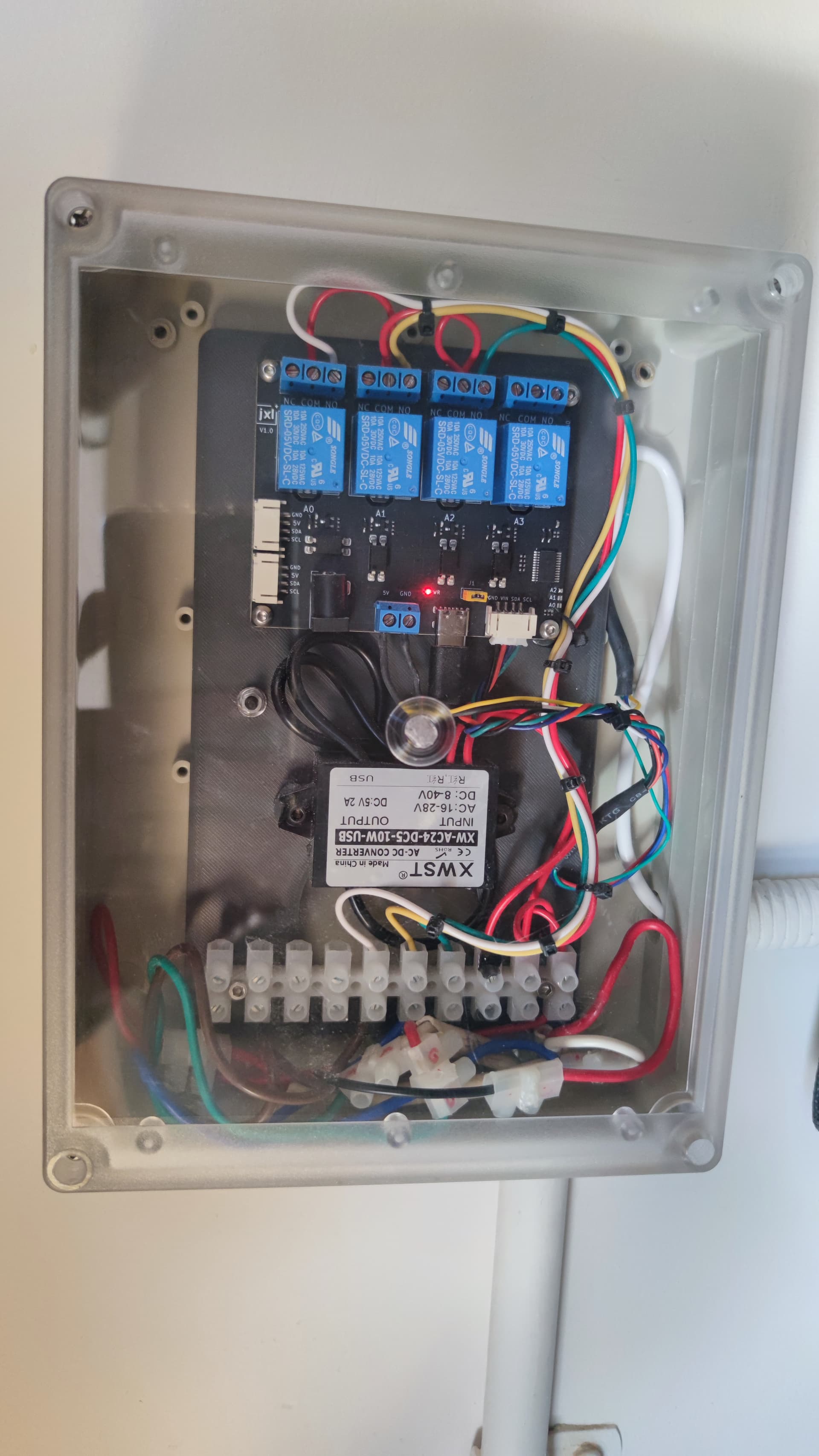

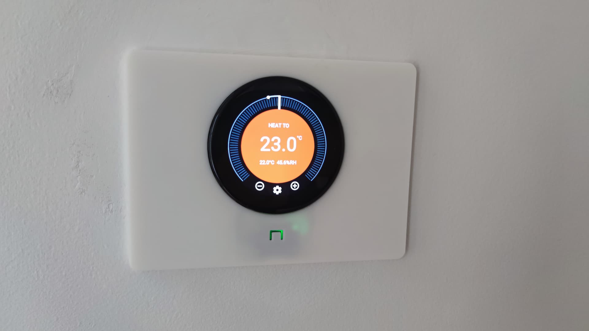

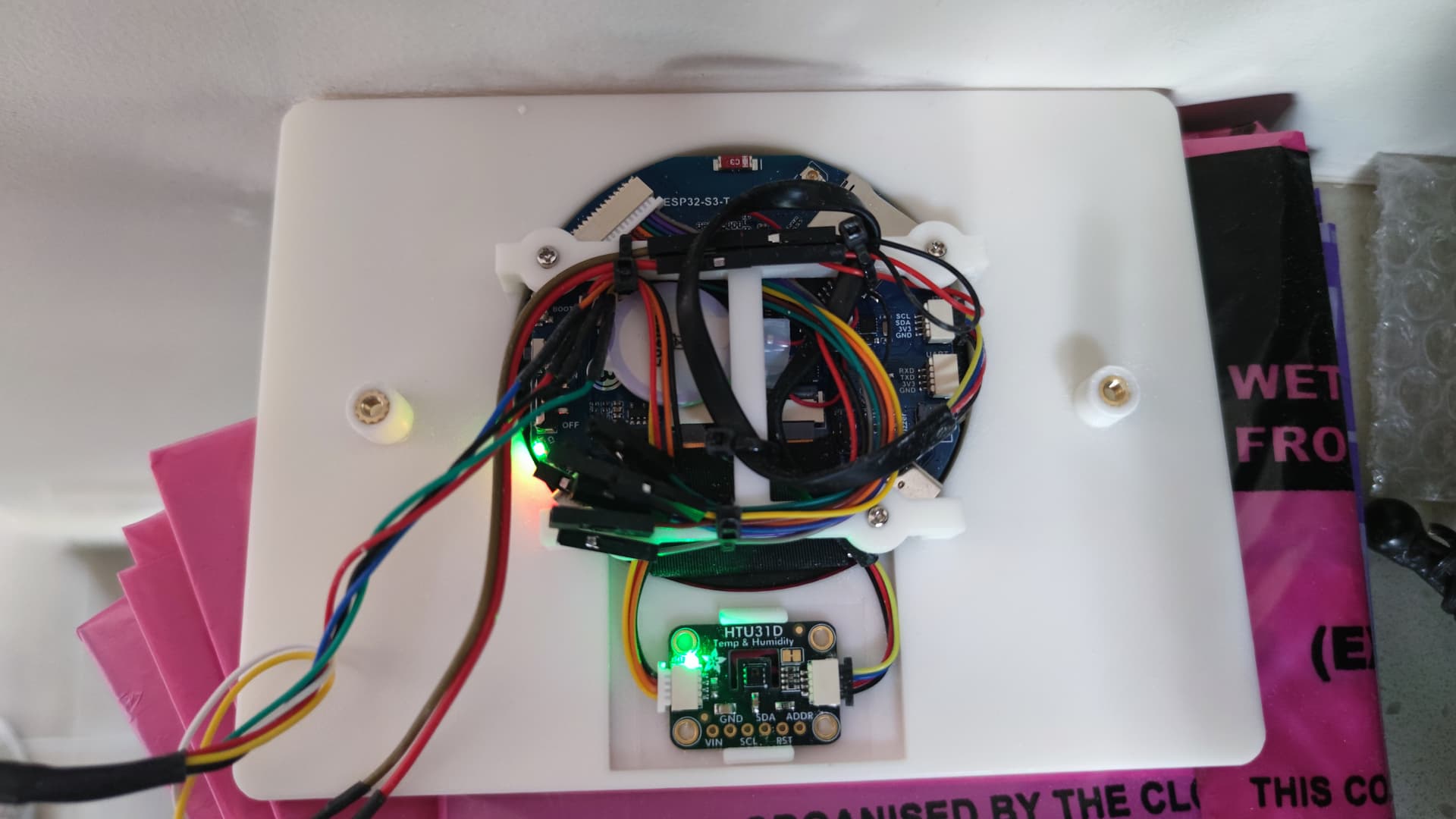

Just wanted to send a big thanks to @veli and @kto for their great work. I’ve ported their code to a Waveshare 2.1" curved edge round touch display. Its standalone. It can use HA but its not dependant on it for operation. Removed my 2nd gen Nest yesterday and installed the ā€œNespā€.
In case it is of interest I’ve uploaded my code here : GitHub - wineds/neo-nesp: Nest Thermostat clone on a rotary display running @esphome
looks bloody nice, love the profile of the touch screen, may need to replace my chunky rotary device now :slight_smile:
