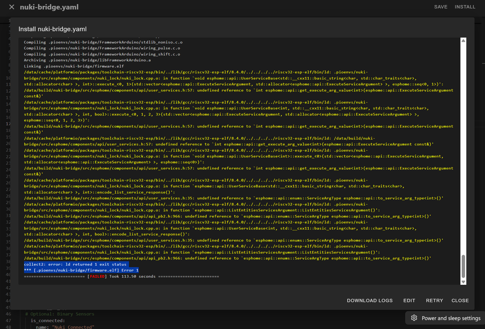

.piolibdeps/nuki-bridge/NukiBleEsp/src/NukiBle.h:386:10: error: 'list' in namespace 'std' does not name a template type
std::list<KeypadEntry> listOfKeyPadEntries;
.piolibdeps/nuki-bridge/NukiBleEsp/src/NukiBle.h:386:5: note: 'std::list' is defined in header '<list>'; did you forget to '#include <list>'?
.piolibdeps/nuki-bridge/NukiBleEsp/src/NukiBle.h:22:1:
+#include <list>
.piolibdeps/nuki-bridge/NukiBleEsp/src/NukiBle.h:387:10: error: 'list' in namespace 'std' does not name a template type
std::list<AuthorizationEntry> listOfAuthorizationEntries;
.piolibdeps/nuki-bridge/NukiBleEsp/src/NukiBle.h:387:5: note: 'std::list' is defined in header '<list>'; did you forget to '#include <list>'?
.piolibdeps/nuki-bridge/NukiBleEsp/src/NukiBle.h:316:10: error: 'void Nuki::NukiBle::onDisconnect(NimBLEClient*)' marked 'override', but does not override
void onDisconnect(BLEClient*) override;
In file included from src/esphome/components/nuki_lock/nuki_lock.h:10,
from src/esphome.h:30,
from src/main.cpp:3:
.piolibdeps/nuki-bridge/NukiBleEsp/src/NukiLock.h:257:37: error: 'std::list' has not been declared
void getTimeControlEntries(std::list<TimeControlEntry>* timeControlEntries);
.piolibdeps/nuki-bridge/NukiBleEsp/src/NukiLock.h:257:41: error: expected ',' or '...' before '<' token
.piolibdeps/nuki-bridge/NukiBleEsp/src/NukiLock.h:264:29: error: 'std::list' has not been declared
void getLogEntries(std::list<LogEntry>* requestedLogEntries);
.piolibdeps/nuki-bridge/NukiBleEsp/src/NukiLock.h:264:33: error: expected ',' or '...' before '<' token
.piolibdeps/nuki-bridge/NukiBleEsp/src/NukiLock.h:349:10: error: 'list' in namespace 'std' does not name a template type
std::list<TimeControlEntry> listOfTimeControlEntries;
.piolibdeps/nuki-bridge/NukiBleEsp/src/NukiLock.h:349:5: note: 'std::list' is defined in header '<list>'; did you forget to '#include <list>'?
.piolibdeps/nuki-bridge/NukiBleEsp/src/NukiLock.h:6:1:
+#include <list>
.piolibdeps/nuki-bridge/NukiBleEsp/src/NukiLock.h:350:10: error: 'list' in namespace 'std' does not name a template type
std::list<LogEntry> listOfLogEntries;
.piolibdeps/nuki-bridge/NukiBleEsp/src/NukiLock.h:350:5: note: 'std::list' is defined in header '<list>'; did you forget to '#include <list>'?
.piolibdeps/nuki-bridge/NukiBleEsp/src/NukiLock.h:351:10: error: 'list' in namespace 'std' does not name a template type
.piolibdeps/nuki-bridge/NukiBleEsp/src/NukiLock.h:351:5: note: 'std::list' is defined in header '<list>'; did you forget to '#include <list>'?
*** [.pioenvs/nuki-bridge/src/main.cpp.o] Error 1
========================== [FAILED] Took 3.40 seconds ==========================
I don't know where and if should I make corrections
