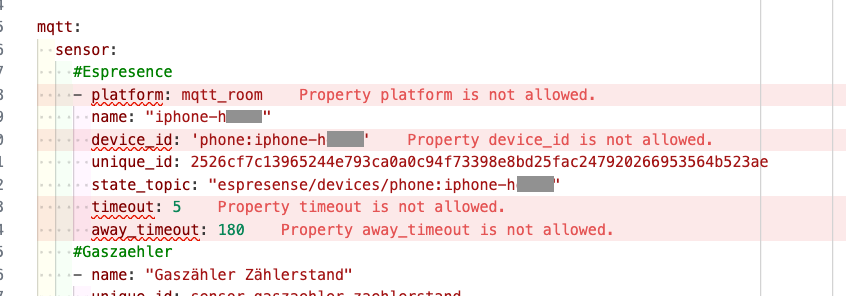

I join with my question once: My problem lied in integrating into the configuration.yaml. So far, nobody can help where the problem lies.
Error: platform mqtt_room property platform is not allowed

You are using the wrong domain. The mqtt-room integrations does not have to be under mqtt:, it must be under sensor:
so it has to look like:
sensor:
  - platform: mqtt-room
    device_id: "phone:iphonehXXX"
