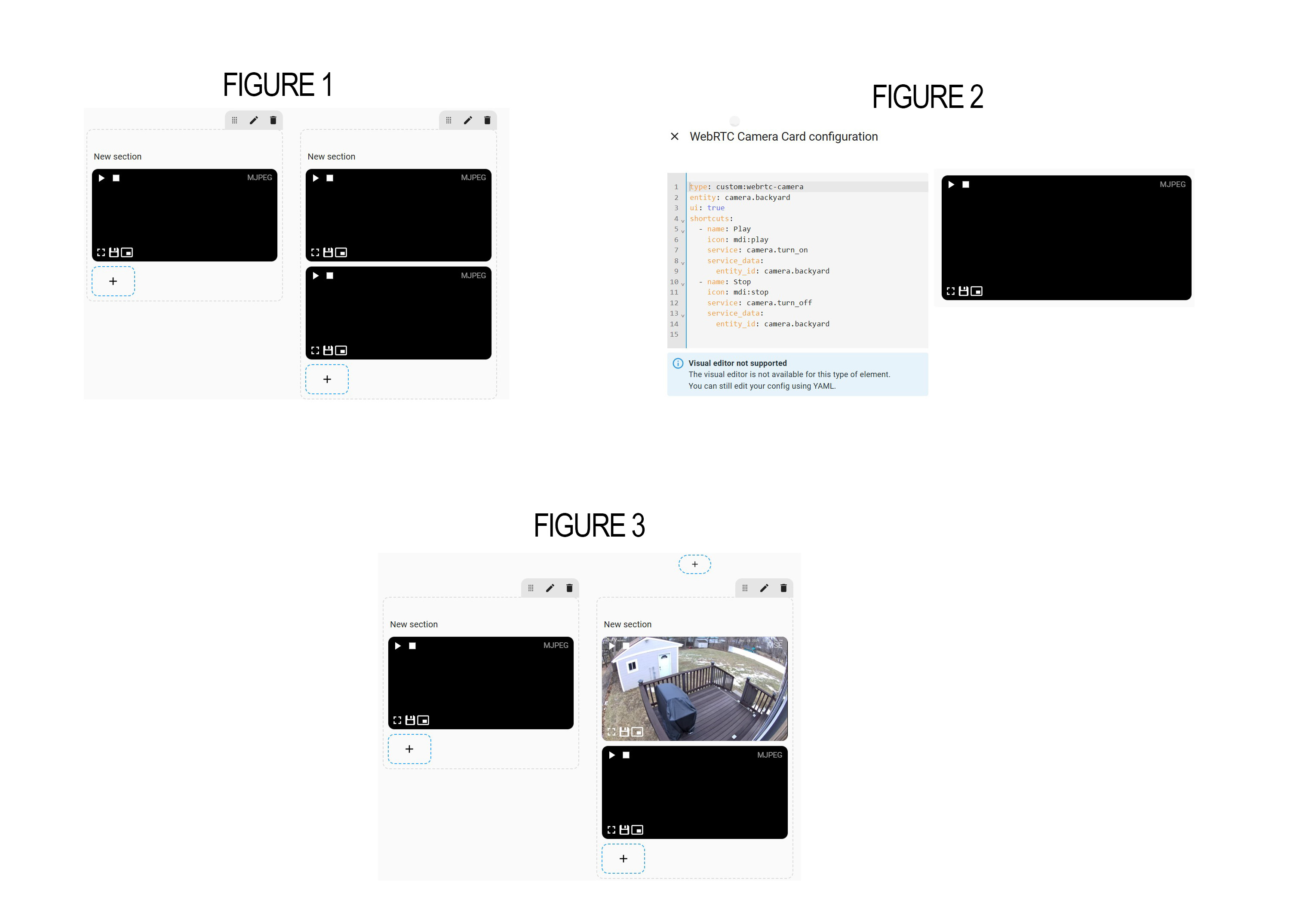

Ok … I found something by complete accident that appears to trigger the SoloCam S340 to work. Here’s the scenario I have setup on a test WebRTC camera card on a test dashboard:
  1. I have 3 Eufy cameras as shown in the figure 1 picture
  • Doorbell (Far left section by itself)
  • Backyard (top of right section)
  • Shop Rear (bottom of left section)
    When I go to edit mode on the section (figure 2 picture), click play and then click the save button on the card on either the backyard or shop rear cameras from the dashboard, I get either a black screen or the green screens like @MrNorth45 shows above. However, if after I click the save button on the card, I then drag the position of the camera card from top to bottom or vice-versa, the connection establishes properly and plays without a problem (figure 3 picture). Any thoughts that this issue of playing the SoloCam s340s should work but are being thwarted by something on the WebRTC card? The fact that the s340s work after a refresh show that they will actually work but are being interfered with by something potentially with the WebRTC card code.
UPDATE: It appears to also work if you just hit refresh a few times on screen with which you are viewing the feed from and doesn’t require you to swap positions of the cards.
FIGURES:
