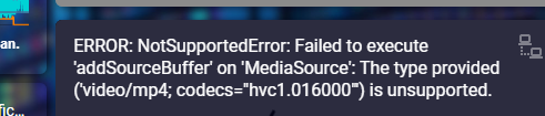

But how about my Battery Doorbell 2k? It does not support RTSP (obviously) and when I activate it I first get a
followed by
or simply
In the RTSP addon, I see this in the log:

So to me it seems I configured it right, the camera stream comes up to the RTSP add-on. What did I miss?
Set all options to low in camera settings. Low quality, low codec etc. This error is about video codec is not supported by webrtc
