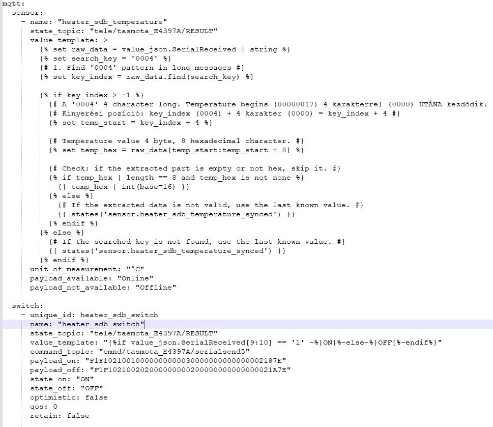

Thank you! Could you please share the complete ESP configuration for Eurom?
Do you have any other auxiliary files included?

Here’s my current version, really hoping for some feedback on this!
