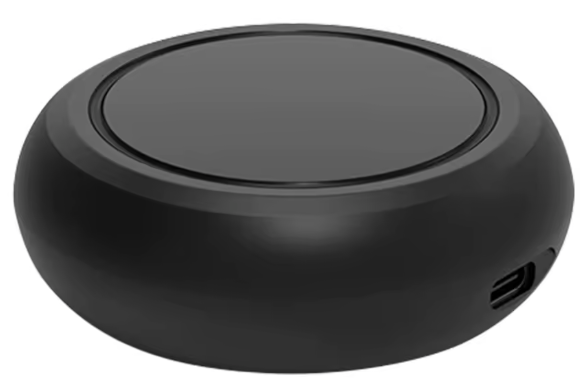

I spent $3($6 off sale) on an AliExpress IRC03 IR transmitter/receiver -
Flashed it with the IrRemoteESP variant of OpenBeken (requires soldering, standard variant does not support ACs for IR), and connected it to HA via MQTT.

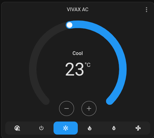

Then I found out my AC uses Coolix commands by reading the OpenBeken IR logs in their webapp, so I used this article Controlling Coolix-compatible AC using OpenBeken/OpenBK7231T-Compatible IR Blaster | Octo’s rants and setup AppDaemon addon in HA.
After some edits, back and forth with the author of the script, and playing with MQTT Explorer to diagnose some issues, I had a working setup, here - scripts/coolix.py · master · Martin / configs · GitLab
