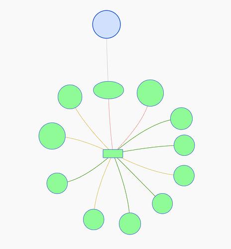

Here’s a little before and after of the changes I’ve made. Everything will be green except the furthest door once I replace the aqara door sensors (which refuse to talk to the sonoff router).
This is more like how it should look when you have routing devices setup in the mesh:
ignore the red one in this one as that is an aqara t2 relay I am waiting for an electrician to install but have it already paired and setup.
That does NOT look good, there does not look to be any mesh networking going on at all. You should add many more Zigbee Router devices. Yeah I going to once again refer you to the read and try to follow the best practice this here → Zigbee networks: how to guide for avoiding interference + optimize using Zigbee Router devices (repeaters/extenders) to get a stable mesh network with best possible range and coverage
FYI, Aqara’s Zigbee devices are infamous for not automatically moving to better/closer Zigbee Router devices on their own, it is well known within the community that you will need to manually re-pair/re-join Aqara devices after you add more Zigbee Router devices.
Most other Zigbee devices revealuate neiboring Zigbee Router devices and usually automatically move around once every 24-hours if there are any better/closer Zigbee devices available.
I’ve actually repaired the aqara sensors multiple times to the sonoff router and they just go straight back to the coordinator. Even though the router is much closer. I’ve already ordered some sonoff door sensors to replace them.
The topology I am going for is essentially a linear backbone based on sonoff routers with a SkyConnect coordinator. Assuming those devices are robust (which is perhaps a poor assumption) what is the value of adding more routers to get some meshing going?
