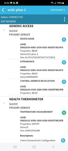

Hi
I am trying to emulate a Xiaomi Mijia BLE temperature sensor using an ESP32 and ESPHome. Could anyone please let me know the device name Xiaomi uses, and maybe a screen capture like below showing me under which headings the temperature / humidity and battery level data appears?
My use case is I already have an ESP32 with an indoor temperature sensor, and I would like to send this data to a ‘Faikin’ (Daikin heat pump controller) uisng BLE. The Faikin will accept temperature data from a Xiaomi Mi - which is why I am trying to emulate that device.
Thank you
Interesting idea. Exactly which xiaomi device do you need to emulate. Saying “xiaomi mi” just throws is into a cesspool of similarly named devices.
Got it sorted…
Just needed to send a data stream like this
