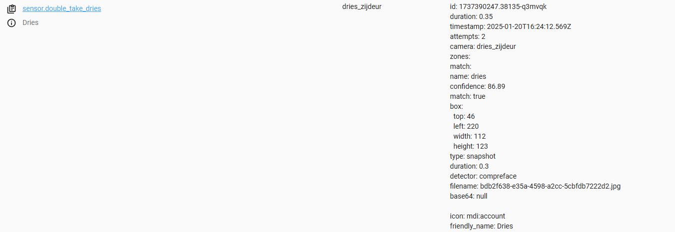

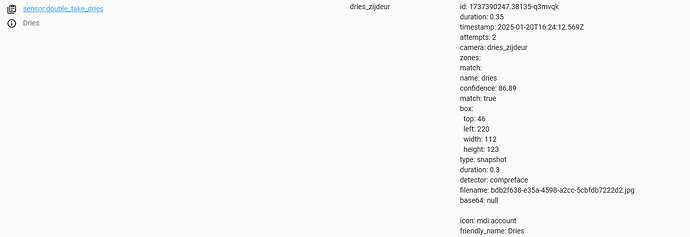

So I succeeded in setting up the Frigate-Compreface-DoubleTake combination. And so far it is going wel.
If a match is found, this is correctly published to the relevant sensor:
I’ve tried to set up a notification based on the template provided in the documentation.
This automation has the following condition
condition:
  - condition: template
    value_template: '{{ trigger.to_state.state != trigger.from_state.state }}'
My MQTT sensor has the camera name in the state field (see screenshot). And that doesn’t change (the various attributes change though). What I notice is that my automation gets triggered, but doesn’t pass the condition check and as a consequence no notification is send.
I could obviously remove that condition, but I guess it’s there for a reason?

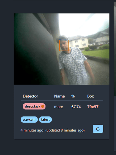

hello,
i set everything up and he finds the person that i trained, but the mqtt sensor doesnt work, the sonsor gets no update?!
mqtt:
  host: 192.168.0.73
  username: marc
  password: !secret mqtt_password
  client_id: double-take
  topics:
    # mqtt topic for frigate message subscription
    frigate: frigate/events
    #  mqtt topic for home assistant discovery subscription
    homeassistant: homeassistant
    # mqtt topic where matches are published by name
    matches: double-take/matches
    # mqtt topic where matches are published by camera name
    cameras: double-take/cameras
mqtt:
  sensor:
    - name: "marc_frigate"
      icon: mdi:account
      state_topic: 'double-take/matches/marc'
      json_attributes_topic: 'double-take/matches/marc'
      value_template: '{{ value_json.camera }}'
      availability_topic: 'double-take/available'
