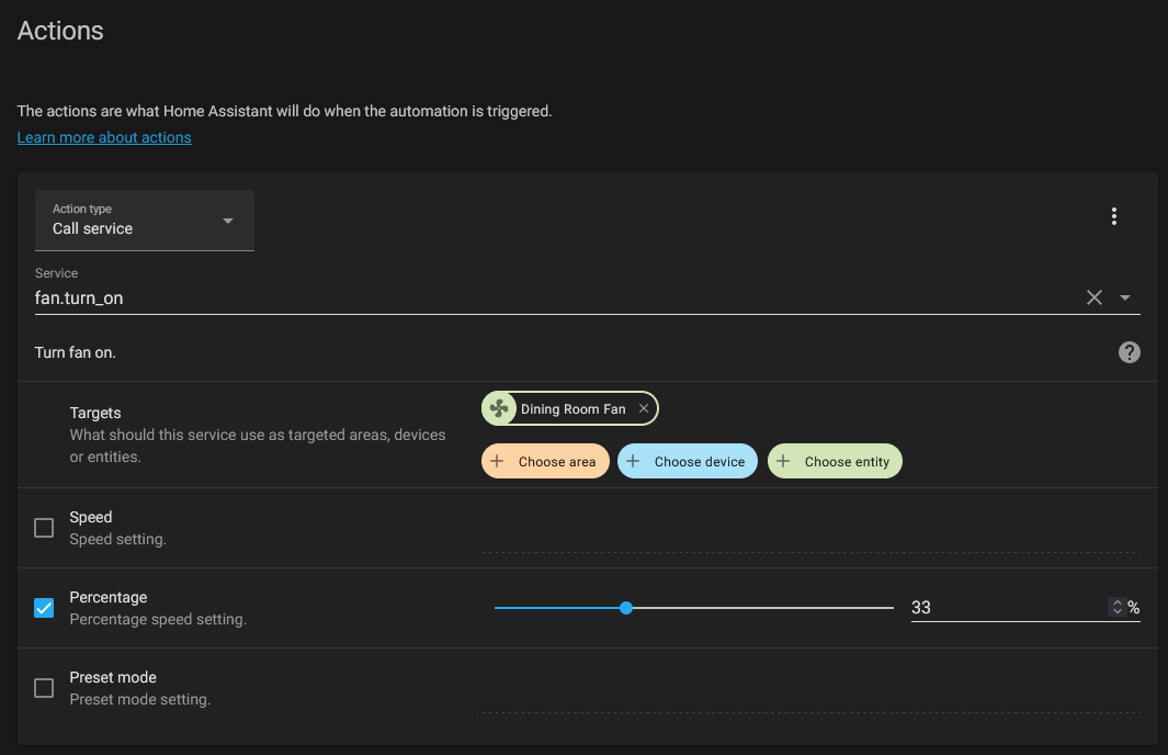

one question that keeps bugging me is…
When I set up an automation for an Sonoff iFan03 it works with no errors in log.

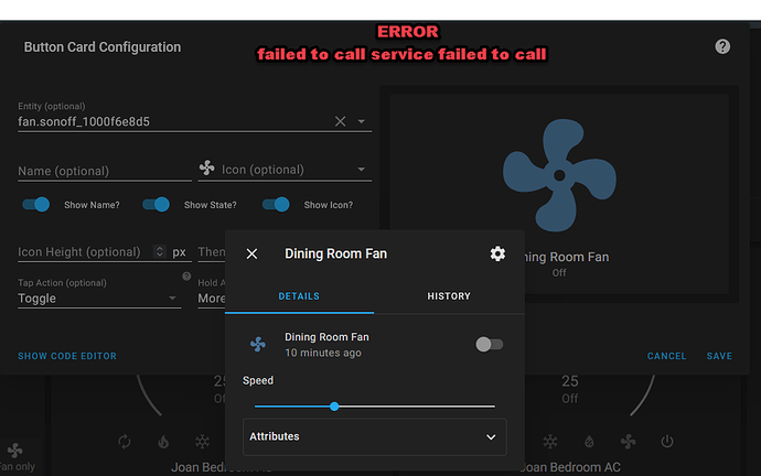

However when I try to set up a standard Button Card i get this…
Is this as a result of SonoffLAN @AlexxIT or is there another issue?

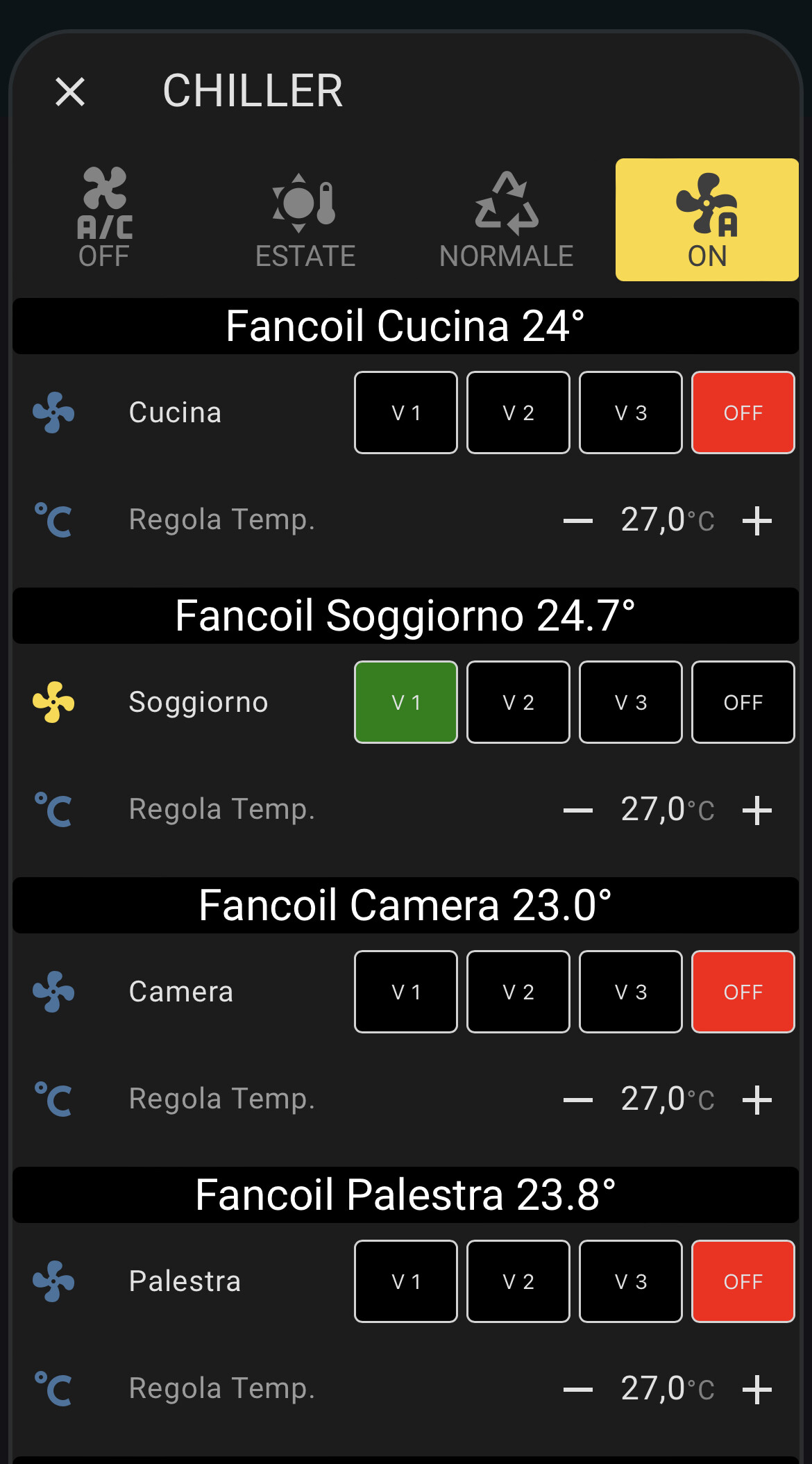

Hello there,
I need some help with fan-percent-button-row, when I pressed a velocity button this do not assume is color (the fancoil it works fine, the percentage is a mqtt command to onewire device)
Thanks

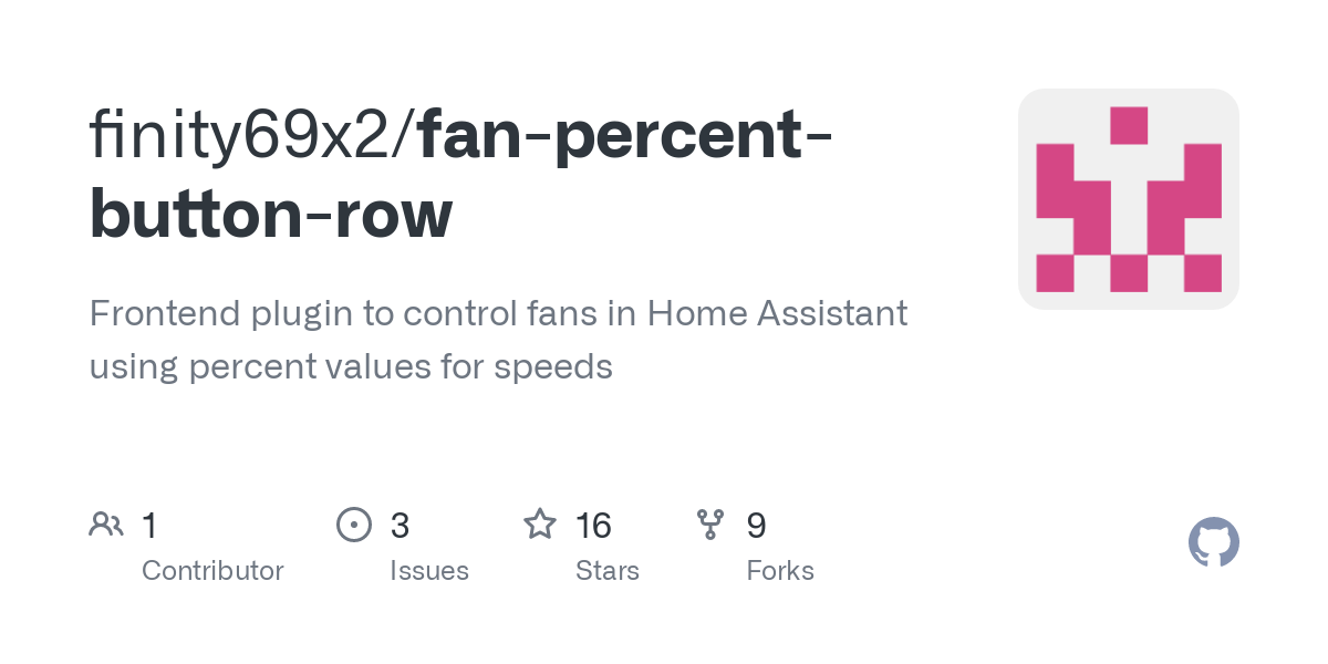

Can you do me a favor and try reversing the percentage setpoints?
lowPercentage: 4
medPercentage: 8
hiPercentage: 16
I remember there was an issue a while back if the low was actually the highest number is wouldn’t work correctly. I thought I fixed it tho.
And just to clarify…you are saying that the fan actually turns on the correct speed but it’s just that the buttons don’t change color to reflect the actual speed?
Hello, nothing changed,

No it’s not possible as far as I know at least with the built-in stuff or my plugin.
