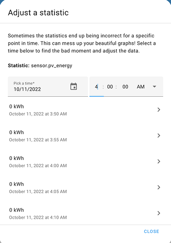

EDIT: Interesting is that i can’t see this wrong data in the dev toold statistic tab:
I have played with the hours and always 0. Maybe it’s because of it’s the “integration platform” sensor?
As you see in Developer tools you can correct the statistics, aka long term statistics.
If you corrected the statistics for your energy sensor then it should show the right values in your Energy tab.
You shouldn’t care about short term statistics as it will be discarded after a few days unless you are storing all values in an InfluxDB to display it with Grafana, then you should correct your value there.
Obviously your pv_energy short term statistics has been fudged not at 4AM, but after 8AM, so you have made some magic wrong there.

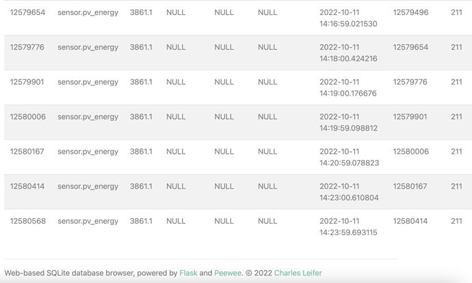

Result:
Checked PV states with a command:
SELECT *
FROM "states"
WHERE
  entity_id ='sensor.sun2000_10ktl_m1_sun2000_12_bt2150240752'
  and last_updated between '2022-10-11 00:00:00' and '2022-10-12 23:59:00'
There is no wrong data there, as I cleaned it this morning.
I’ll start the HA now, and post what happens in db

If you see it there, then it means you can fix it through developer tools. You just need to find the hour where it is happening and set it to 0.
How does the short term looks?
just did it myself, works as a charm :wink:
You just have to find the sensor and the date🤔
I did as the instruction but no luck:
Screenshot 2022-10-12 at 13.46.41
I even scrolled through every hour that date, but no luck
I think you have the wrong sensor?
Try looking for Consumed Solar (if that is the one that’s wrong) :wink:

Have you changed the minutes as well? Because every time when you show this picture you show only the whole hour.
The data will be stored somewhere during the hour, not just at the start or end of the hour.
So i commented out the integration sensor in configruation.yaml , corrected the DB, switched to new pv integration and looks like it’s solved.
And yes, i changed minutes as well.
