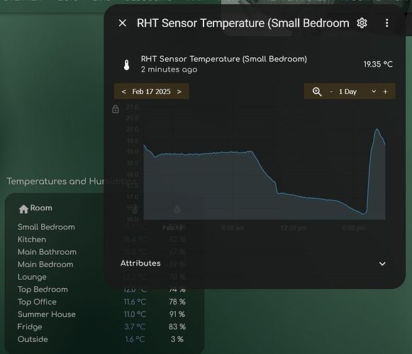

I wonder if @Ildar_Gabdullin you might be able to help with another problem. I would like to be able to click on either the temperature value or the humidity value, and have it bring up the relevant graph. At the moment, clicking either of them both brings up the same temperature graph:
Do you know how I can get it to take me to the humidity graphs instead when clicking on that value?
Thanks
You got ONE particular entity (sensor.xxx) with attributes like “temp” & “humidity” - and now expect to see more-info with a graph for a particular attribute? )
Yes I was under the impression we could graph the attributes. But I guess not from what you said.
