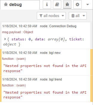

Yes, It was 7.2 at that time but it was not updated after that at all. Do you think, I have to create these flows again?
Maybe you messed up something in the flow, delete the flow (keep helpers, they look ok) and try import flow again.

Sorry, canât see why it wouldnât work, the only explanation that sounds reasonable is, that Iâm on a newer api version and youâre still on the old, can you try the original flow as posted above?

[{"id":"1d53e8e8cb49d6ee","type":"tab","label":"Libre","disabled":false,"info":"","env":[]},{"id":"3f93eda1ef013b57","type":"http request","z":"1d53e8e8cb49d6ee","name":"Libre Link Auth API Call","method":"POST","ret":"obj","paytoqs":"ignore","url":"https://api-au.libreview.io/llu/auth/login","tls":"5f0b28b1aaa052cb","persist":false,"proxy":"","insecureHTTPParser":false,"authType":"","senderr":false,"headers":[{"keyType":"other","keyValue":"Pragma","valueType":"other","valueValue":"no-cache"},{"keyType":"other","keyValue":"Version","valueType":"other","valueValue":"4.7.0"},{"keyType":"other","keyValue":"product","valueType":"other","valueValue":"llu.ios"},{"keyType":"other","keyValue":"Cache-Control","valueType":"other","valueValue":"no-cache"},{"keyType":"other","keyValue":"Accept-Language","valueType":"other","valueValue":"en-AU,en;q=0.9"},{"keyType":"other","keyValue":"Content-Type","valueType":"other","valueValue":"application/json"}],"x":690,"y":40,"wires":[["6e74824d3048d6c2"]]},{"id":"d682318c.36823","type":"debug","z":"1d53e8e8cb49d6ee","name":"Connection Debug","active":true,"tosidebar":true,"console":false,"tostatus":false,"complete":"payload","targetType":"msg","statusVal":"","statusType":"auto","x":570,"y":200,"wires":[]},{"id":"ef169e174831491a","type":"http request","z":"1d53e8e8cb49d6ee","name":"Libre Link Connections API Call","method":"GET","ret":"obj","paytoqs":"query","url":"https://api-au.libreview.io/llu/connections","tls":"5f0b28b1aaa052cb","persist":false,"proxy":"","insecureHTTPParser":false,"authType":"","senderr":false,"headers":[{"keyType":"other","keyValue":"Pragma","valueType":"other","valueValue":"no-cache"},{"keyType":"other","keyValue":"Version","valueType":"other","valueValue":"4.7.0"},{"keyType":"other","keyValue":"product","valueType":"other","valueValue":"llu.ios"},{"keyType":"other","keyValue":"Cache-Control","valueType":"other","valueValue":"no-cache"},{"keyType":"other","keyValue":"Accept-Language","valueType":"other","valueValue":"en-AU,en;q=0.9"},{"keyType":"other","keyValue":"Content-Type","valueType":"other","valueValue":"application/json"},{"keyType":"other","keyValue":"Authorization","valueType":"msg","valueValue":"token"}],"x":210,"y":200,"wires":[["d682318c.36823","4af54317f78a2c03","0641052c53bdd52a","3c263e5bfcb22e4a"]]},{"id":"6e74824d3048d6c2","type":"function","z":"1d53e8e8cb49d6ee","name":"Convert Token to Bearer token","func":"\n// Assuming you have a variable named 'token'\nvar token = msg.payload.data.authTicket.token; // Replace 'msg.payload.token' with the actual path to your token variable\n\n// Prepend 'Bearer ' to the token\nvar bearerToken = 'Bearer ' + token;\n\n// Update the message payload with the new bearer token\nmsg.token = bearerToken;\n\n// Return the modified message object\nreturn msg;\n\n","outputs":1,"timeout":0,"noerr":0,"initialize":"","finalize":"","libs":[],"x":470,"y":120,"wires":[["ef169e174831491a"]]},{"id":"b84131edd60d5143","type":"api-call-service","z":"1d53e8e8cb49d6ee","name":"Update Name BGL","server":"f5d6c7d4.360698","version":5,"debugenabled":false,"domain":"input_number","service":"set_value","areaId":[],"deviceId":[],"entityId":["input_number.Name_bgl"],"data":"","dataType":"jsonata","mergeContext":"","mustacheAltTags":false,"outputProperties":[],"queue":"none","x":810,"y":260,"wires":[[]]},{"id":"4af54317f78a2c03","type":"function","z":"1d53e8e8cb49d6ee","name":"Convert BGL Payload","func":"// Check if msg.payload.data[0] and msg.payload.data[0].glucoseMeasurement exist\nif (\n msg.payload &&\n msg.payload.data &&\n msg.payload.data[0] &&\n msg.payload.data[0].glucoseMeasurement\n) {\n // Access the Value property\n var bgl = msg.payload.data[0].glucoseMeasurement.Value;\n\n // Assign the value to msg.bgl\n// msg.payload.bgl = bgl;\n// msg.payload = '';\n msg.payload.data.shift();\n msg.payload.data.value = bgl;\n} else {\n // Handle the case where the necessary properties are not present\n console.error(\n \"Missing properties in msg.payload.data. Unable to set msg.bgl.\"\n );\n}\n\nreturn msg;\n\n","outputs":1,"timeout":0,"noerr":0,"initialize":"","finalize":"","libs":[],"x":540,"y":260,"wires":[["b84131edd60d5143"]]},{"id":"0df0514713297b08","type":"inject","z":"1d53e8e8cb49d6ee","name":"Start","props":[{"p":"payload"},{"p":"topic","vt":"str"}],"repeat":"","crontab":"","once":false,"onceDelay":0.1,"topic":"","payload":"","payloadType":"date","x":90,"y":120,"wires":[["0730b4d04dd91244"]]},{"id":"95e0a95020a138f1","type":"cron","z":"1d53e8e8cb49d6ee","name":"Start Every 5 Mins","crontab":"*/5 * * * *","x":130,"y":40,"wires":[["0730b4d04dd91244"]]},{"id":"381d6fd4e0855b9b","type":"api-call-service","z":"1d53e8e8cb49d6ee","name":"Update Name BGL Trend Arrow","server":"f5d6c7d4.360698","version":5,"debugenabled":false,"domain":"input_number","service":"set_value","areaId":[],"deviceId":[],"entityId":["input_number.Name_bgl_trend_arrow"],"data":"","dataType":"jsonata","mergeContext":"","mustacheAltTags":false,"outputProperties":[],"queue":"none","x":850,"y":320,"wires":[[]]},{"id":"0641052c53bdd52a","type":"function","z":"1d53e8e8cb49d6ee","name":"Convert BGL Payload","func":"// Check if msg.payload.data[0] and msg.payload.data[0].glucoseMeasurement exist\nif (\n msg.payload &&\n msg.payload.data &&\n msg.payload.data[0] &&\n msg.payload.data[0].glucoseMeasurement\n) {\n // Access the Value property\n var trendarrow = msg.payload.data[0].glucoseMeasurement.TrendArrow;\n msg.payload.data.shift();\n msg.payload.data.value = trendarrow;\n} else {\n // Handle the case where the necessary properties are not present\n console.error(\n \"Missing properties in msg.payload.data. Unable to set msg.payload.\"\n );\n}\n\nreturn msg;\n\n","outputs":1,"timeout":0,"noerr":0,"initialize":"","finalize":"","libs":[],"x":540,"y":320,"wires":[["381d6fd4e0855b9b"]]},{"id":"e1a1c0781889539f","type":"api-call-service","z":"1d53e8e8cb49d6ee","name":"Update Name Sensor Serial Number","server":"f5d6c7d4.360698","version":5,"debugenabled":false,"domain":"input_text","service":"set_value","areaId":[],"deviceId":[],"entityId":["input_text.Name_libre_sensor_serial_number"],"data":"","dataType":"jsonata","mergeContext":"","mustacheAltTags":false,"outputProperties":[],"queue":"none","x":860,"y":380,"wires":[[]]},{"id":"3c263e5bfcb22e4a","type":"function","z":"1d53e8e8cb49d6ee","name":"Convert Sensor Serial Number","func":"// Check if msg.payload.data[0] and msg.payload.data[0].glucoseMeasurement exist\nif (\n msg.payload &&\n msg.payload.data &&\n msg.payload.data[0] &&\n msg.payload.data[0].glucoseMeasurement\n) {\n // Access the Value property\n var sensorsn = msg.payload.data[0].sensor.sn;\n msg.payload.data.shift();\n msg.payload.data.value = sensorsn;\n} else {\n // Handle the case where the necessary properties are not present\n console.error(\n \"Missing properties in msg.payload.data. Unable to set msg.payload.\"\n );\n}\n\nreturn msg;","outputs":1,"timeout":0,"noerr":0,"initialize":"","finalize":"","libs":[],"x":570,"y":380,"wires":[["e1a1c0781889539f"]]},{"id":"0730b4d04dd91244","type":"function","z":"1d53e8e8cb49d6ee","name":"Get Libre Link Credentials","func":"var libreuser = global.get('libre_link_user');\nvar librepass = global.get('libre_link_pass');\n// Create or modify the JSON body\nvar jsonBody = {\n email: libreuser,\n password: librepass\n};\n\n// Set the modified JSON as the output\nmsg.payload = jsonBody;\nreturn msg;","outputs":1,"timeout":0,"noerr":0,"initialize":"","finalize":"","libs":[],"x":410,"y":40,"wires":[["3f93eda1ef013b57"]]},{"id":"5f0b28b1aaa052cb","type":"tls-config","name":"TLS","cert":"","key":"","ca":"","certname":"","keyname":"","caname":"","servername":"","verifyservercert":false,"alpnprotocol":""},{"id":"f5d6c7d4.360698","type":"server","name":"Home Assistant HA1","version":5,"addon":true,"rejectUnauthorizedCerts":true,"ha_boolean":"y|yes|true|on|home|open","connectionDelay":true,"cacheJson":true,"heartbeat":false,"heartbeatInterval":"30","areaSelector":"friendlyName","deviceSelector":"friendlyName","entitySelector":"friendlyName","statusSeparator":"at: ","statusYear":"hidden","statusMonth":"short","statusDay":"numeric","statusHourCycle":"h23","statusTimeFormat":"h:m","enableGlobalContextStore":true}]
The warning raised in the debug means that the payload comming back from the API is different than the one I get.
Still the same.
Sorry, unable to help without access to your HA. Iâd need to look at the payloads⊠maybe someone else will have some idea.
Perhaps the original author of the flow.
