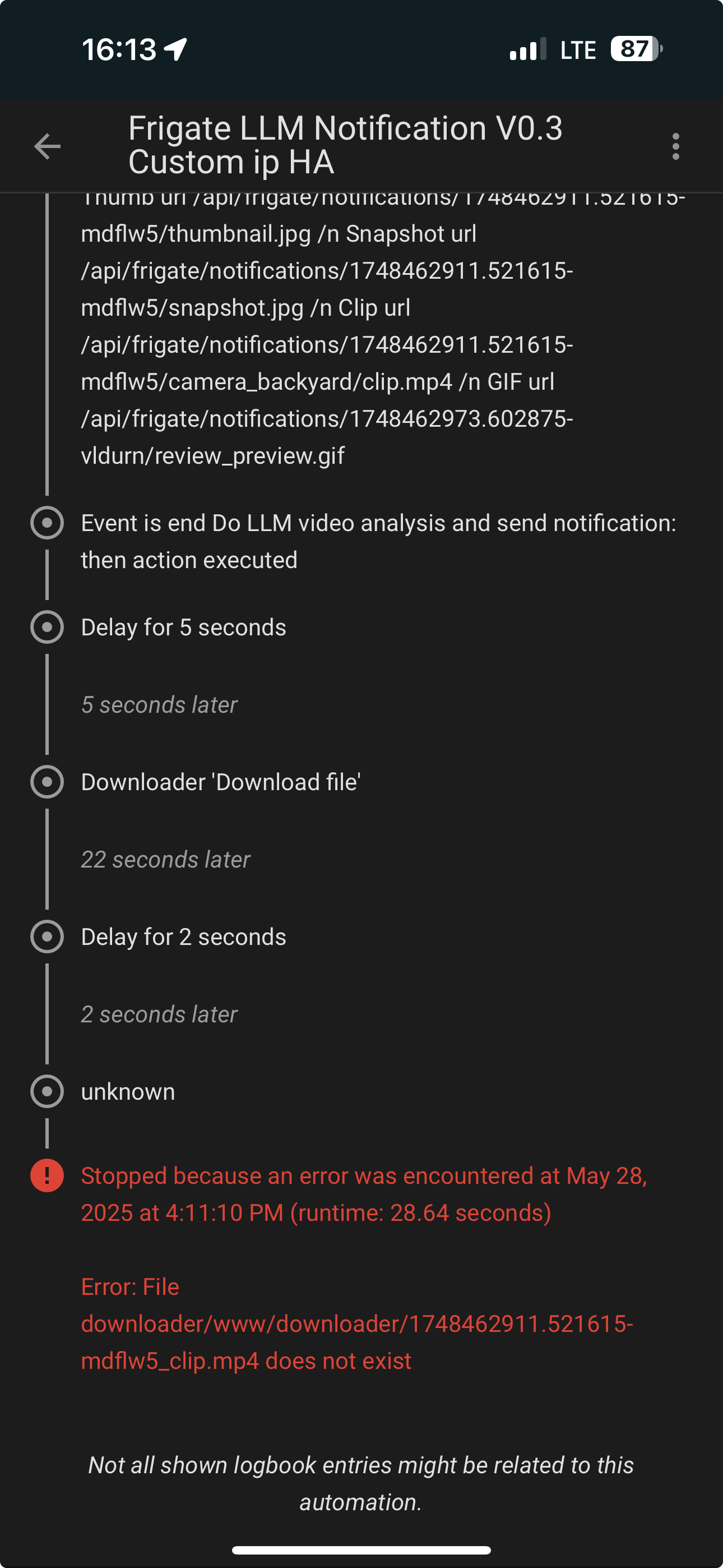

My downloaded folder is empty.
There is something I’m missing. I had a similar issue where the files did not exist when the api call was sent.
I don’t want to put the blame on your great blueprint! It probably is not.
If you have any debug steps in mind, I would really appreciate!
Thanks

Can you both try the home assistant ip address and port please
My input description should really be the Home Assistant IP address , because this is the api i am interacting with in this automation( /api/frigate/notifications/).
As you have mentioned you can access the HTTP api
(api/events).
For my part, I’m running HA on a raspberry pi and my frigate box is a separate dell computer. It is integrated to HA using the frigate proxy add on.

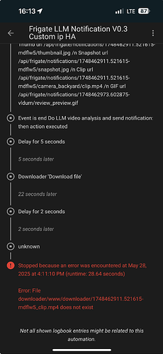

So I used the HA ip address as you said and now when I look at the trace timeline it looks like this:
I didn’t have that message before. Just the unknown step.
Got it, for some reason, i had the downloader subfolder filled in with www/downloader… it works now! So using the ha api linked to frigate! Now I better understand the difference… thanks so much!
