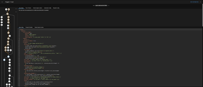

Anyone using this on iOS 17? I stopped getting notifications and am trying to troubleshoot the reason…
I’m on iOS17 beta for 2 days and I’m getting notifications as before. No change. I’m on version of the blueprint 0.11.0.16e. I believe I still have local push off. Did you try that?
If you mean in the iOS HA app, local push is currently disabled…what’s weird is I haven’t touched anything other than updating to iOS 17. The automation triggers as always and I do get other HA notifications. I am on v12 of this blueprint though…although it wokred fine when on iOS16.
EDIT: Just tried v11 of the blueprint and still nothing…very strange…
Try a fresh automation for v11. Unsure if the caching issue is resolved. (HA issue not specific to this)
Still nothing…I don’t know if it helps but if I look at the trace timeline it says “triggered by the mqtt topic frigate/events at time blah blah” and then “Choose: no action taken”
Please screenshot the trace diagram. At least up until it stops doing things.
First half looks fine. It attempted to send a notification.
Unsure why it stops there though. Was it an extremely short event
Well I grabbed an iPad and put iOS 17 on it and notifications come through…so it’s something with my iPhone13 on iOS 17 that isn’t working…I’ve checked notification settings and HA app and all looks the same as the iPad…huh…
UPDATE: All good…changed the name of the iPhone on the companion app and boom - it works…technology can be weird…thanks guys…
