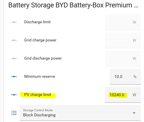

Hi @redpomodoro. I just received a battery for my solar system, and this integration is incredibly useful. Thank you for this work.
Now, I have small problem: Some of the controls seem to incompletely work.
For example if I switch to Block discharging, I cannot change the parameter. More to the point, I can type, but the value never seems to be validated. If I go out/in, it reverts to default.
I updated my inverter software, but no effect.
I searched the forums,but did not see any clue. Any idea bout this problem?

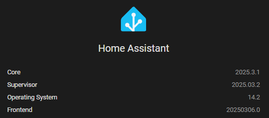

Hi @redpomodoro. Until yesterday I was totally happy to use your integration. Thanks a lot for your great work on that. But since last night somehow the setting of the control mode in combination with the values doesn’t work anymore.
I set the mode to “Charge from Grid” and the value of “Grid Charge power” to 3300 W. In the Logbook the change of the mode is confirmed but 3s later the logbook tells that the mode changed to “Discharge” and another 10 seconds later the logbook tells the mode changed to “Holding”. In this mode ist stays
untill I set it backt to “Auto” which is changed then immediatley.
The setting of the “Grid Charge Power” seems not change, when I enter the values.
Do you have a clue what went wrong, or what I should try out to test?
Best regards from South Germany.
Same problem with the core version 2025.3.1 - switching back to 2025.2.5 let me work again. The main problem was that “Cahrge to grid” was not working anymore. Maybe it is a phyton problem…
I had some problems after upgrading my inverter firmware to latest 1.35 version - my EV charger refused to work with it afterwards, maybe that could also be part of the problem?
